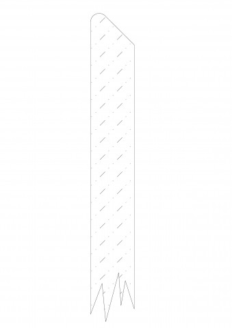

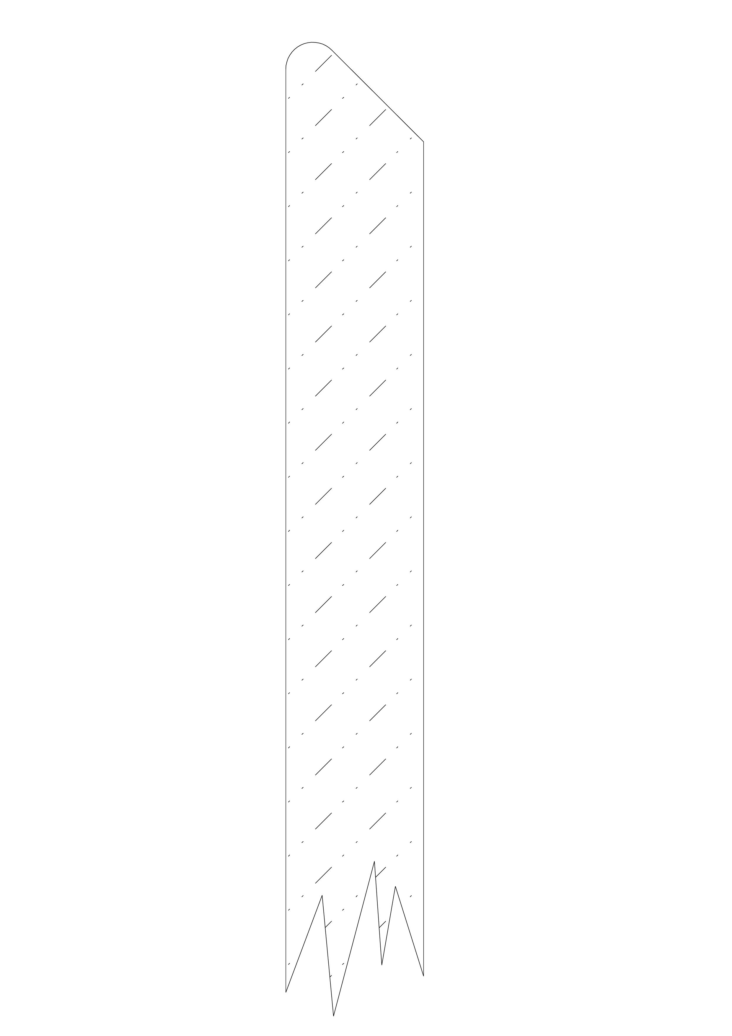

The doors have a 3mm rad on the face and a bevel with a slight rad at the top applied to the top back of doors and drawers.
The sheets would need to flipped and I am curious as to the accuracy of where the radius's meet and the time taken to do a average kitchen.
Is there much tidying up to do, meaning would the top radius need touching up or would they be ready for undercoating.
Is it worth doing on the machine or is it quicker to use the panel saw and hand held trimmer with 3 mm bit
