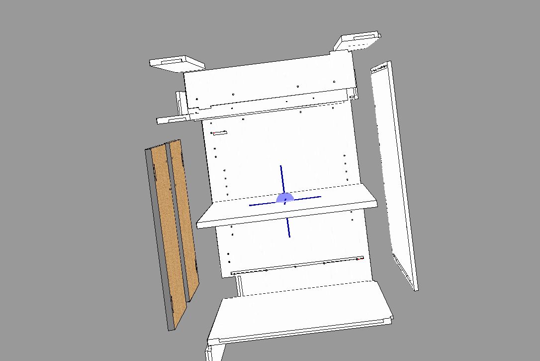

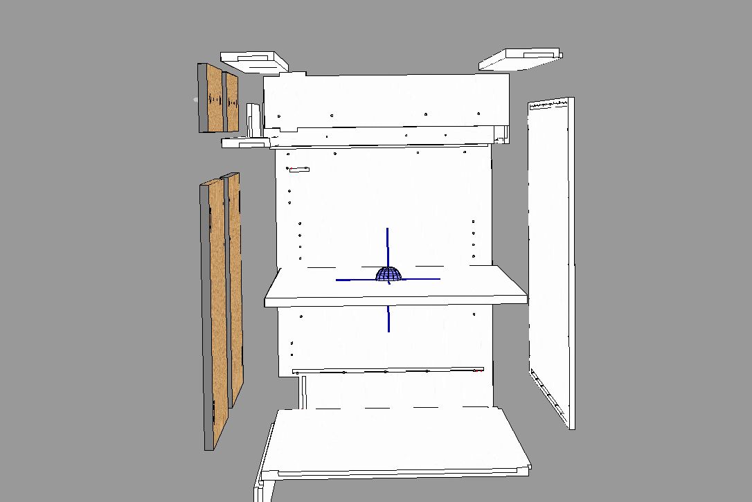

Hello all, I'm not sure if its just me or whats going on, but ever since I updated the software I'm having an issue with my blind dado tenon on my drawer partition. I'm programming a standard 2 drawer, 2 door base cabinet with top stretchers and I cannot get a blind dado/tenon on the underside of the FRONT stretcher. Its only going up under the back stretcher. Any ideas how i can get it back to the way it used to be? I attached 2 pictures. First picture is with the issue I'm having now, second is an older cabinet with what I want

John, can you post the cabinet so we can look at it? Also there is another update 6.1.3 available now that you may want to try first.

Forrest, I sent you a pm, I upgraded to 6.1.3 and still have the same issue
