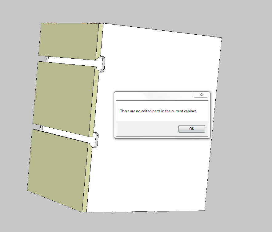

After adding cut outs and profile edges into my cabinet. I want to use constraint manager. See my pic attached for notification.
Getting frustrated? Got a big kitchen to do and this is my seed cabinet.

is this on 6.1.3?

6.1.2. Its a cabinet from my library that I have used earlier this year so this issue should not be happening

just updated to 6.1.3. still not working???? :wall: :wall: :wall:

Can you post the seed cabinet and a list of steps you are doing? Are you starting in the cabinet editor, batch, or room?

Quick update, I work from a batch. Add cabinets from my library and edit as needed. But....its working now. Deleted the batch that I started yesterday. Started fresh. Added my seed. Edited no problem. Still don't know why it had to come to this. This isnt the only time its happened though. Last week I added a seed cabinet to my batch. Made a hole in the left side. Clicked on constraint manger and the same notification came up I posted in pic above. Didnt have time to mess around. Just cut the cabinet and had the guys use a hole saw. Frustrating as hell. Just to damn busy to wait for these things to get fixed. Maybe that Biesse sales guys wasnt talking out his a$$?

There was a bug in 6.1.2 where if you took a cabinet from the batch to cabinet editor then return to batch and selected no to save changes, it would lose pe cuts for that cabinet. This is why we released 6.1.3 so quickly.
