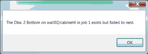

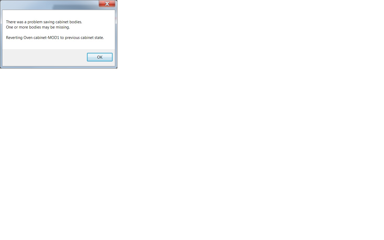

Not sure whats going on with this cabinet but I can't make any changes to it since I upgraded to 6.1.3. I could make all the changes I wanted in 6.1.2.
Went in to delete a shelf and a partition. Clicked on Main and started getting errors.
Please help!! :wall:

Were you working in the batch or room and sending cabinets to the cabinet editor in 6.1.2? There was a bug in 6.1.2 where if you took a cabinet from the batch/room to cabinet editor then return to batch/room and selected no to save changes, it would lose pe cuts for that cabinet If you did this, you would need to recreate your batch/room in 6.1.3 from your seed cabinets.

If you have the orginial cabinet, you can just delete out the bad cabinet, and add it back. Then, go delete your shelf and partition.
