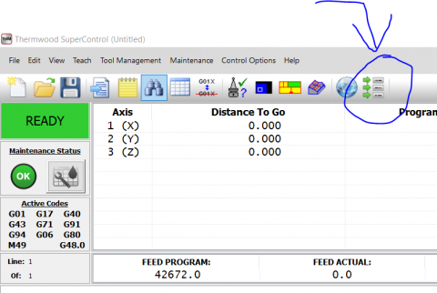

Re: THM Version 10
I was referring to this

Re: THM Version 10
Ah, I apologize, I'm used to going under View, Application View, and choosing Nested Base View. I'll pass the request on about the icon.Thomas strembitsky wrote:I was referring to this

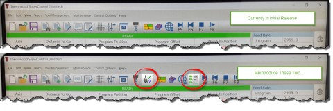

A couple of clients have contacted us here at CNC Automation about these "AWOL" icons on the tool bar.
We have spoken to Thermwood's "Software Support" and have forwarded our suggestion to "reintroduce" these icons back using the free space available.
Fingers crossed for the next update.

I see there's a newer version now. Are the missing icons back? Just wanna make sure before I install. I don't want to lose the verify tooling icon...

Re: THM Version 10
verify tooling is back but they haven't added a button for return to nested view yet
