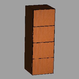

I loaded the cabinet in the "develop cabinets and assemblies, erased your doors and without changing any settings, I added a left hinge door. I started at the top and worked my way down. I had no problems and have attached the cabinet as food pantry 2. I suspect that perhaps windows ten might be an issue. the computer that I used is an old Dell with 4 gigs of ram running windows seven. I normally use a windows 8 computer but thisis the computer that was not in use at the time.
food pantry 2.hsf
(1.13 MiB) Downloaded 1144 times
food pantry 2.jpg (7.37 KiB) Viewed 12380 times

I loaded your cabinet only issue is the doors are difference sizes with the top and bottom being bigger then the middle two. thanks for trying though I'm going to just add the doors first then add the fixed shelves afterwards as it gives me the most control over door size and placement.
