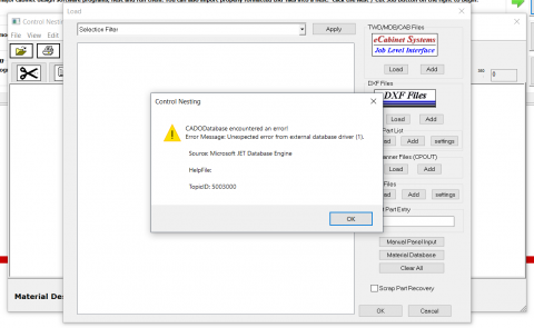

trying to load a excel spreadsheet on the thermwood desktop is also affected by this update

looks like the issue has been fixed with the most recent windows update on November 14, 2017—KB4048955
https://support.microsoft.com/en-ca/help/4048955
