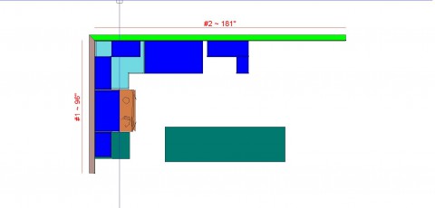

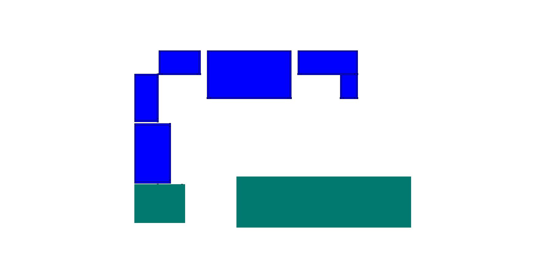

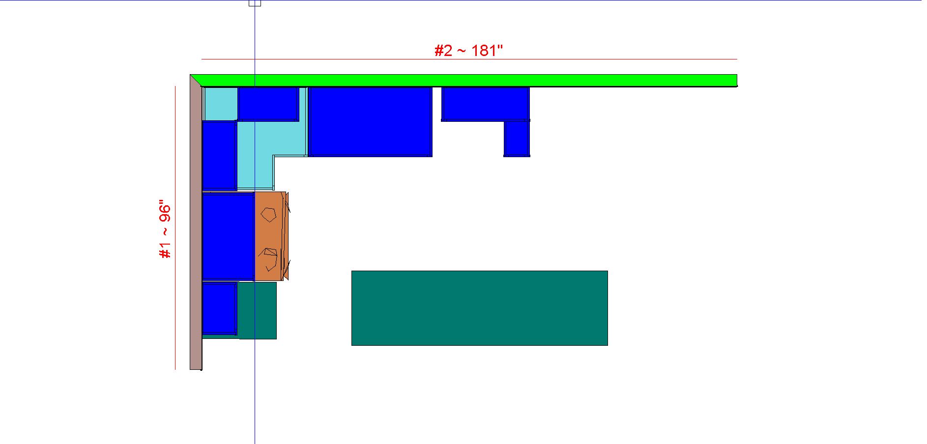

I have a drawing where I have a corner cabinet that has been associated to the main wall #2, but will not show in the countertop page. It does show in all other pages, just not in the countertop page. Any ideas?
Attached is a picture. I would like the countertop to go around the corner.

I don't select a wall when I go to countertops, I just go - maybe that is why its not showing ????

I thought about that, but does not work either. I have tried just about everything, including shutting down the software and re-starting it. Nothing seems to work.

That is strange, have you tried to delete the cabinet then put it back in??
What about a new room with just one wall and that one cabinet??

Yeah, just tried a new wall with just that single cabinet, and it shows up everywhere except the countertop page. I have no clue.

can you upload the cabinet

here you go.

It shows it is an upper cabinet not a base. I can upload one if you need it

Is there a way to change from Upper to Base?

No, from what I read you can mimic a base with an upper and I have before, but there is no way to change it.

Ok, I will see if I can find a corner base cabinet. Seems odd that you would not be able to change the type.
