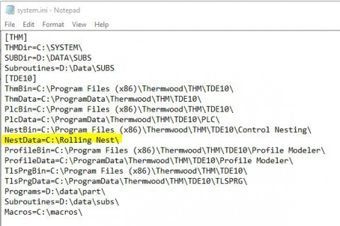

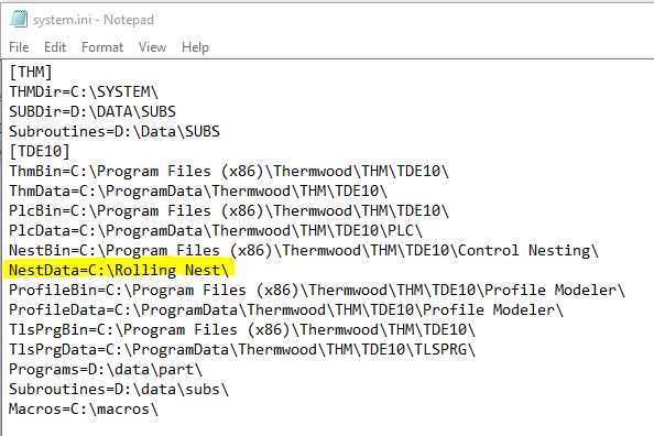

My best guess without seeing is the modifying of the .ini file. Make sure it is still named system.ini and not system.ini.txt. It should look like the attached screenshot. I have general faith in that you were able to copy and paste the files from one location to the next, so the only thing left would be the .ini. Also make sure THM Desktop was shut down when you do these changes.
The label printing software needs the data to exist in C:\Rolling Nest. You copy the folder to create that location. Modifying the .ini tells Control Nesting to populate the C:\Rolling Nest location with the nest data needed for printing.

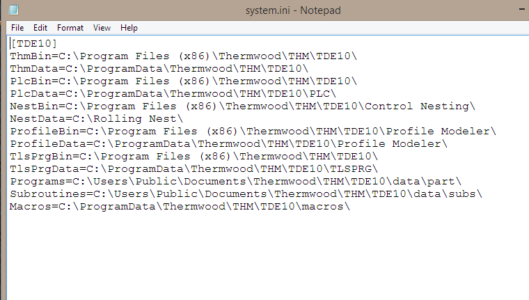

Still scratching my head. Everything looks right, and I have confirmed that the system.ini is indeed looking to C:\Rolling Nest\, because I renamed that folder, and then when I opened THM it wanted me to specify the various directories where it could find things.
Our system.ini files seem to have a couple differences, probably not related, but here's a screencap of mine, in case they are actually related.
