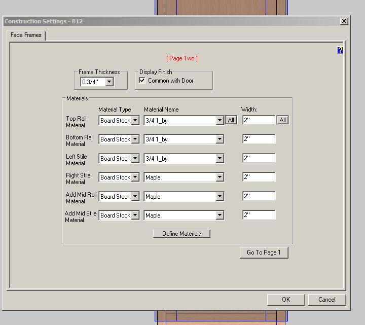

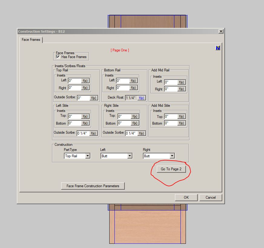

go into face frames and then
consturction settings then into page 2
now you can select differant material for your stiles and set the width as you want
Tim

Doesn't work. As soon as you switch to another thickness it populates the field with that thickness wood and you lose the side stile thicker wood.

Leo Graywacz wrote:Doesn't work. As soon as you switch to another thickness it populates the field with that thickness wood and you lose the side stile thicker wood.
If you click ALL it will populate ALL to the same thickness otherwise you can set each one individually

As soon as I click on another thickness it populates it with the first species in the list with that thickness.
