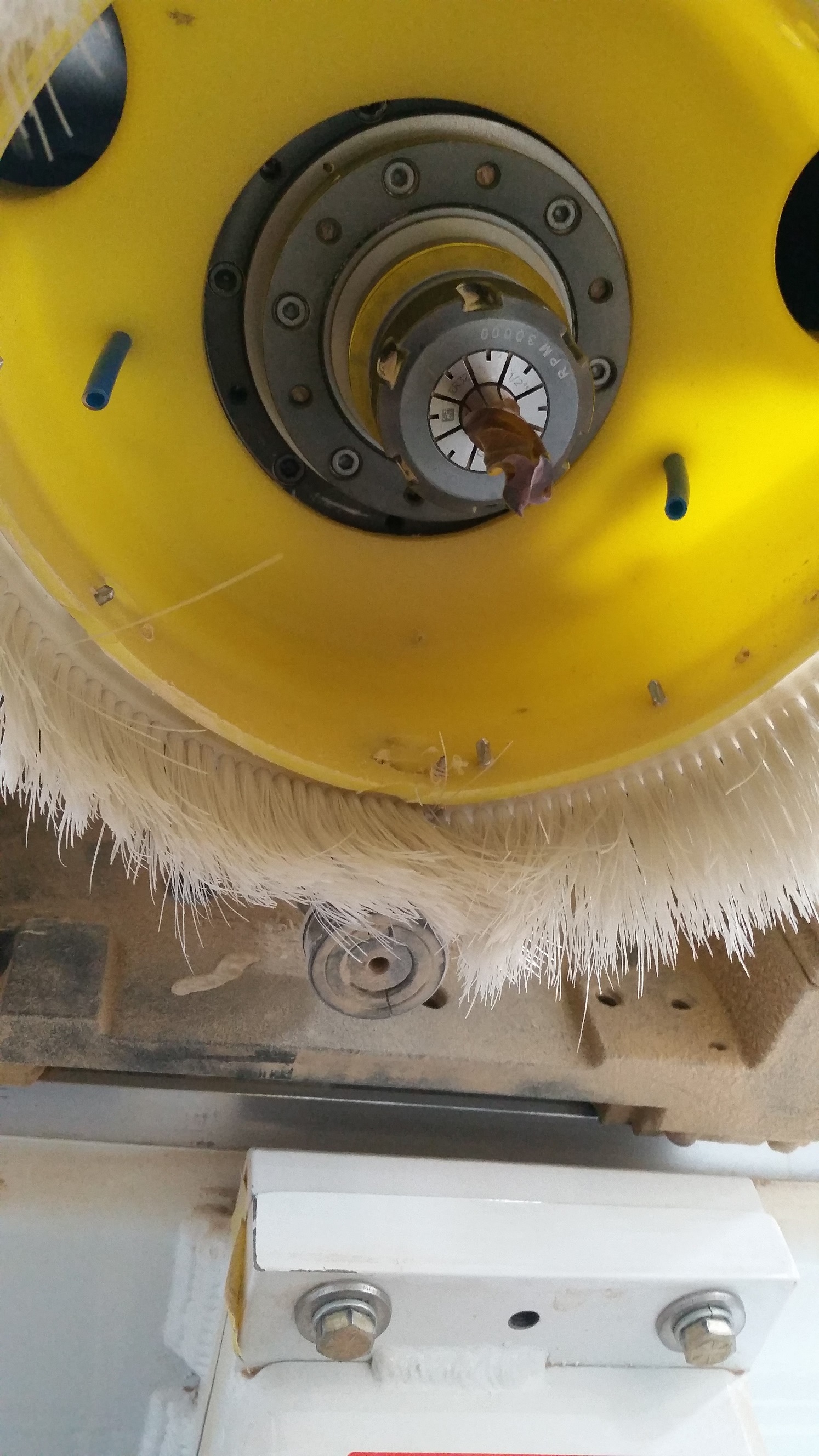

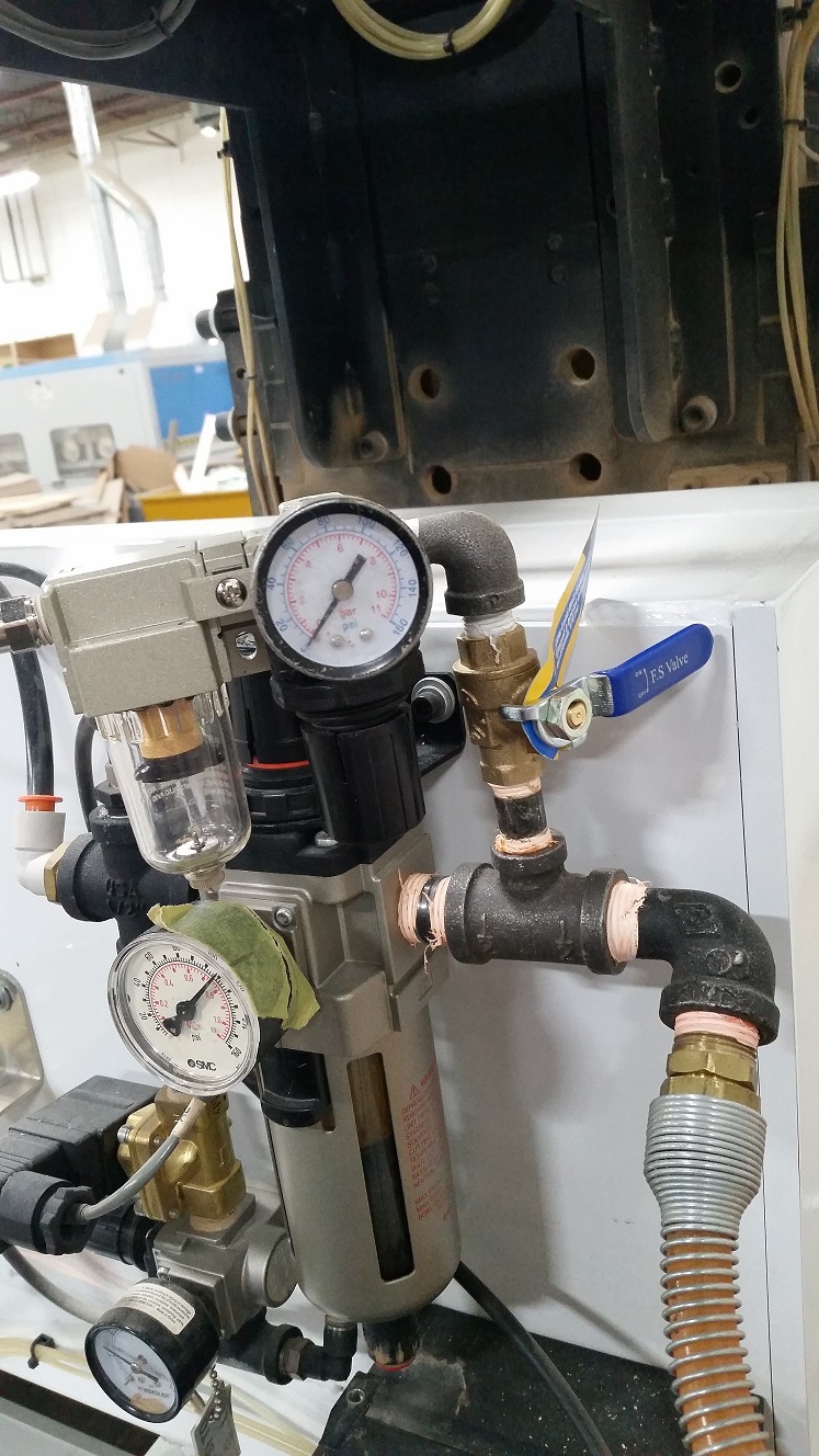

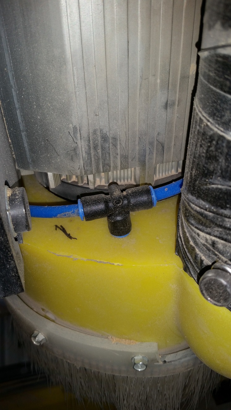

Just wanted to post a few pics of a modification we made to decrease dust left on the table. We added 2 tubes inside the shroud which blows a constant stream of air. Chips not an issue but when we cut mdf, it definitely gets the dust up so the vacuum can do a better job. Little to no dust left on table after.

heres the pics...
