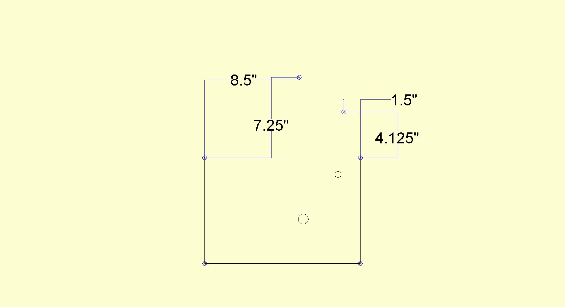

[img]Anyone having problems trying to find the center of a hole cut in a Display panel either with part editor or contour editor? I did a simple display panel cut two holes one with PE and the other with CE, take them into Line drawing Editor use the M key to see my points. Nothing in hole centers BUT I see the M marks completely off the part, almost like it's mirrored.

Chris,
I see the same thing here, I'll pass it along to the software engineers. In the mean time, and as a recommendation, I wouldn't use Display Panels. I rarely ever use Display Panels for anything. I take a cabinet, eliminate all the pieces I don't need and use it as my panel. Then it is resizable, I can change materials, and it can go into Constraint Manager.
