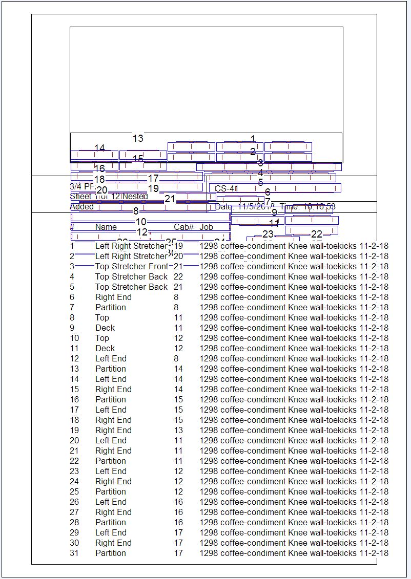

In CN 6.08 (THM desktop) When the "Reverse Sheet Order (global)" option is enabled, and offfall is added, the sheet printouts turn into a mess. Load a job, add a piece of material via Add Sheets, check Reverse Sheet Order, and nest. You have to print to a window or a printer for the issue to show.

Worth a thousand words

Thanks for the info Jeremy. We will get it fixed.
