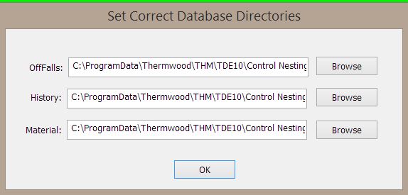

Is it possible to share the offfall database between two machines? Otherwise we end up with racks full of material that has offfall labels, but can only be loaded onto the machine that created it.
Looks like there is an option to independently specify a directory for the offfalls? (as per the screenshot)
CS-41 4x8

Jeremy,
Yes, the feature was implemented for that reason. Make sure it is a location both machines have access to at all times. I would shy against a flash drive.

Perfect, thanks Clint :beer:
