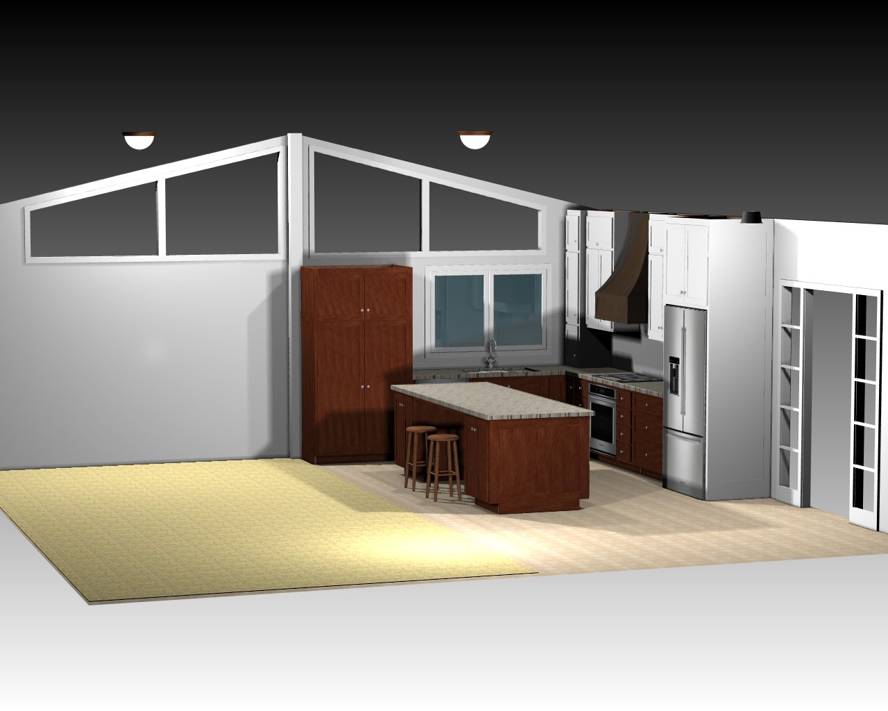

Is there a way to cut trapezoid holes in a wall? I would love to create the look of these windows in the gable end of this home. If there is a way, then next question will be how to create the window. Thank you in advance!

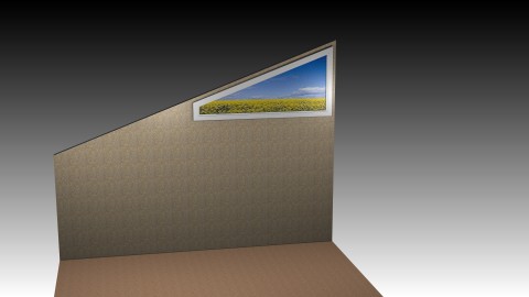

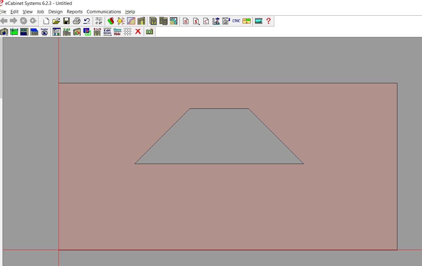

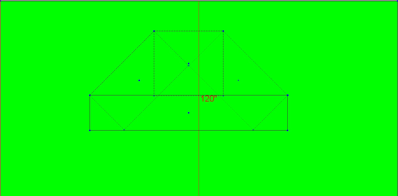

The only way I know to cut a trapezoid in a wall is to use a series of rectangles rotated to cut the pattern.
You may have to use other rectangles to add back geometry.
I would probably use display cubes in the part editor to create the window.

I will try your idea, it might work. Thank you!
Jeff Christenson
Re: How to create trapezoid openings in a wall
It is a clumsy way of getting there but it works.

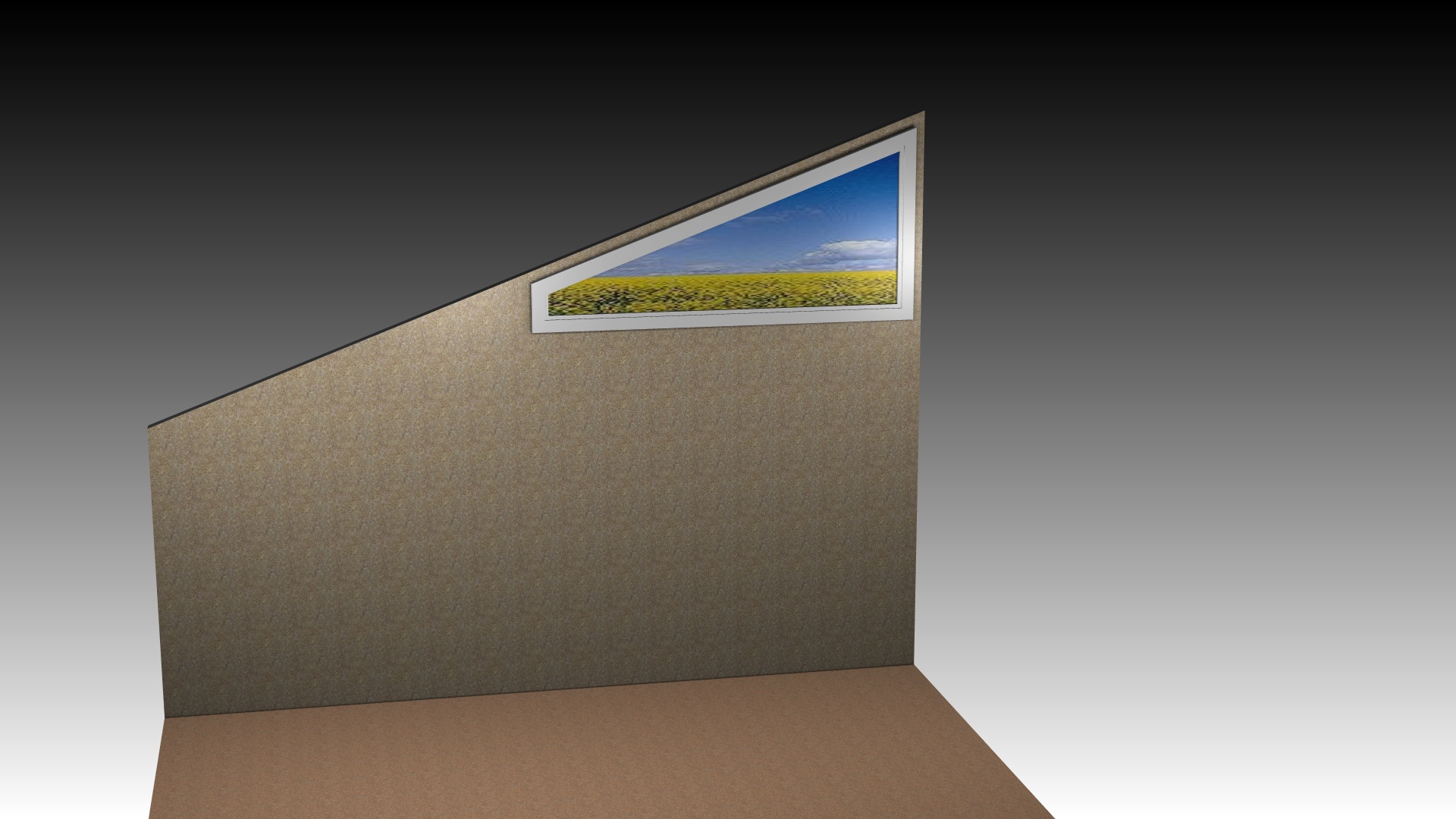

It works! thank you so much!
I think I would forget cutting the hole and just use display cubes

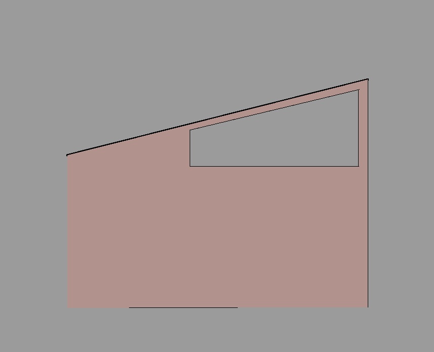

I was able to cut out the windows then add some trim using a stile and left end of a cabinet. Thanks again Kerry!
