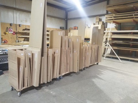

The colored symbols never really worked for me. We use sorting carts and it is hard to remember which slot you put the three green dots in.
As I design I save the cabinets to a job file then when ready to cut, I batch the file, make all the global changes I need then nest them.
the batch labels the cabinets B1,B2 and on which translates well to slot 1 and slot 2 in the sorting cart.

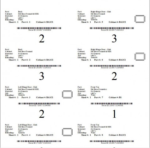

On a more on topic note, the shapes and colors are randomly generated by Control Nesting, not pulled from a database anywhere. Am I correct in seeing that there is a fair amount of real estate available at the bottom of the label? If so I can put a big number there that is a cabinet sorting number. Whatever number is there is the number of a cabinet that the parts go to, not the actual Cabinet Number. If there isn't much room on the label, post a picture of one of yours so I can see what we are working with.
See attached screenshot for what I'm talking about.
If you want something more specific where you are doing double letter combos and different colors, that's going to be a charged service as it will take a bit to get worked out. If you like what you see in the screenshot, I can get you custom ones made and posted as that layout is much simpler.
