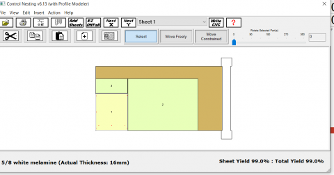

I don't know how the math is being done the but the sheet yield numbers look out to lunch for me see attached picture

It's because the green panels are "off-fall" and are figured at 100% yield, since you can cut them for another project. The only "waste" on that sheet is the kerf!

ok that makes sense now but that's a useless number to know....

Not really a "useless" number to know, but perhaps a future release could indicate "Yield with Off-Falls" and "Yield without Off-Falls"?
