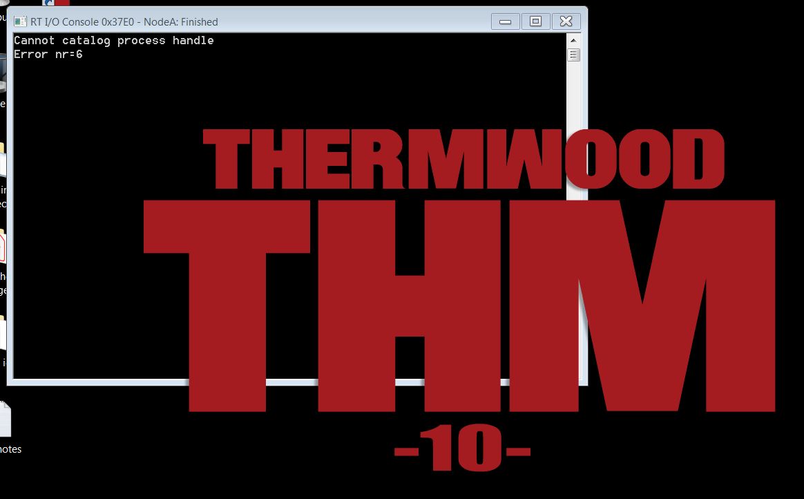

Over the last few days, I've been having difficulty getting THM to start properly. It would display the initial splash screen, but it wouldn't get beyond that. After restarting the computer, it would start properly, and I would go through the rest of the day without any difficulty. This morning though, I can't get it to start at all. I've tried restarting numerous times without success. And I'm getting an error message this morning as well that I haven't seen before.

after continuing restarting several more times, we finally got it to go again, but something is definitely not right...

I've never thought about that possibility. my theory was that the computer is slowing down as it gets older, and startup procedures are taking longer. Last year THM kept giving me error messages that the intime kernel wasn't running, so I set up a 30 second delay on the THM startup, and that erased the problem, since I was giving intime more time to start itself. Now I guess 30 seconds wasn't long enough anymore, so I just disabled autostart altogether.
