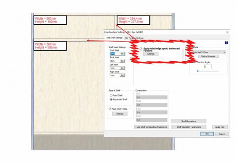

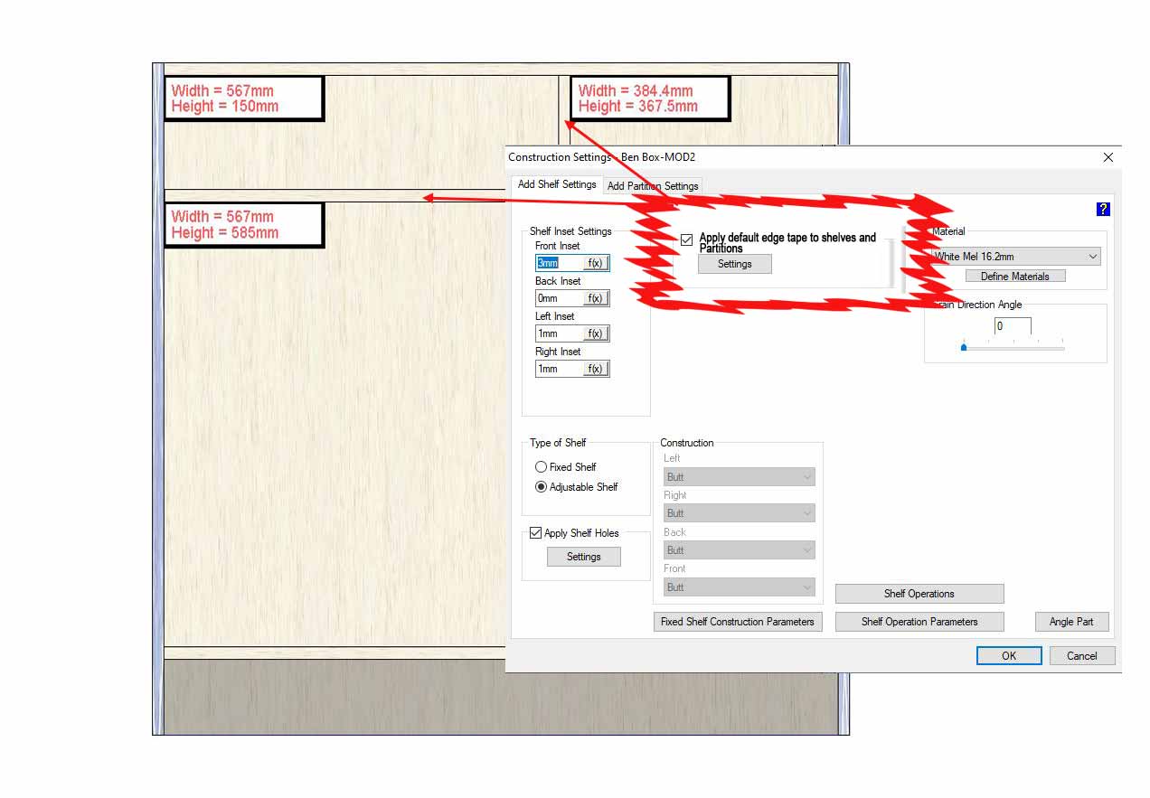

As in the image, I try and use a different colour to highlight it, but different users do different things and like a pretty look even in basic renderings.

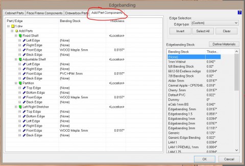

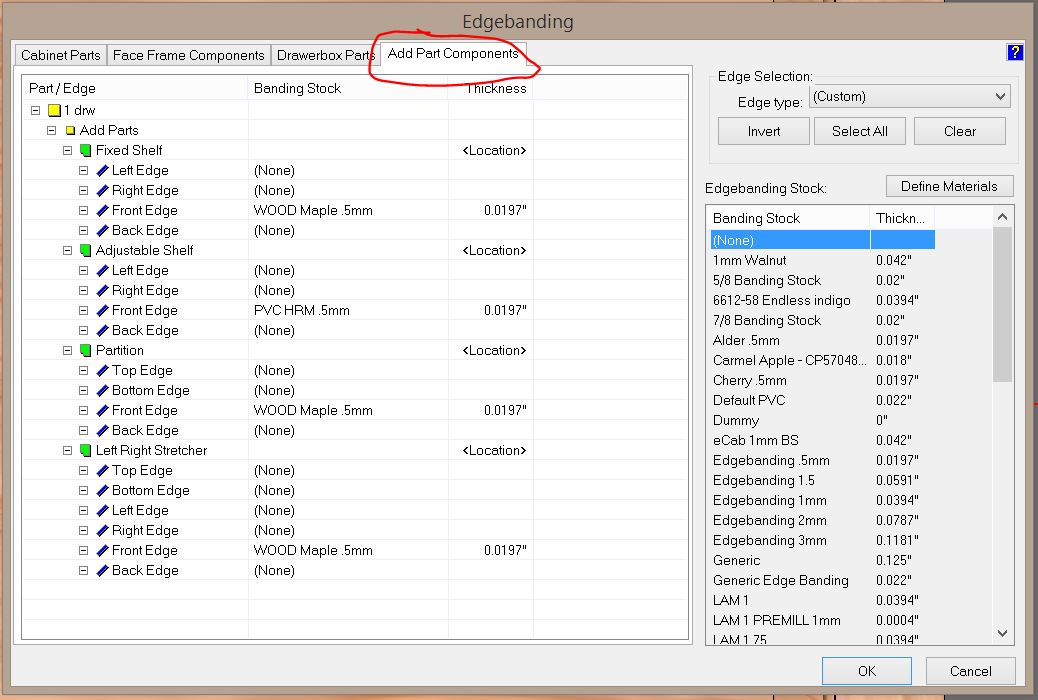

You need to go to the edgebanding editor, not the shelf editor. Click on the Add Part Components, and I think that is what you're looking for:

My query was relating more to a workflow method or procedure,
and would having the edging as a default setting in the construction window, make it less likely that the edging would be left off?
When you set up a seed cabinet for a library, you get that right and start developing. which is good.
But its always those custom cabinets where you take the seed, change things around, delete stuff and add it back in or put in an extra shelf or partition where the edging gets left out.
I like the edging section.
The edging section is very good.
You can select multiple edges and apply the edging with one click, its brilliant!
But its an after thought or after procedure to making of the cabinet where it gets left off.
I was just wondering if others had similar experiences or if its just us that forgets to add it back in.
