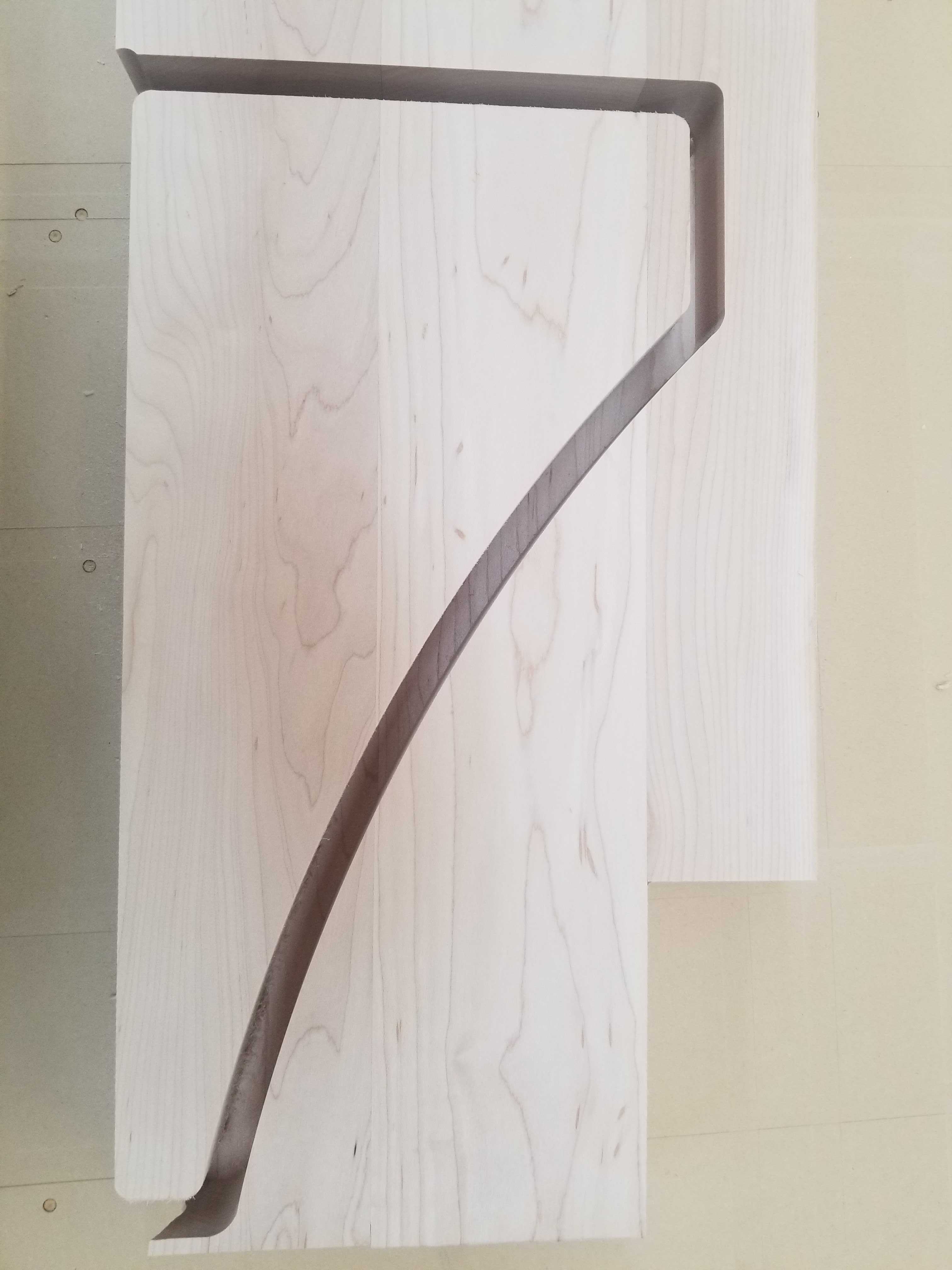

Greetings all!

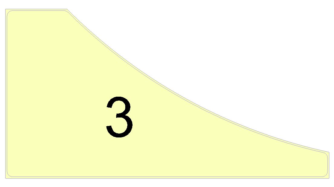

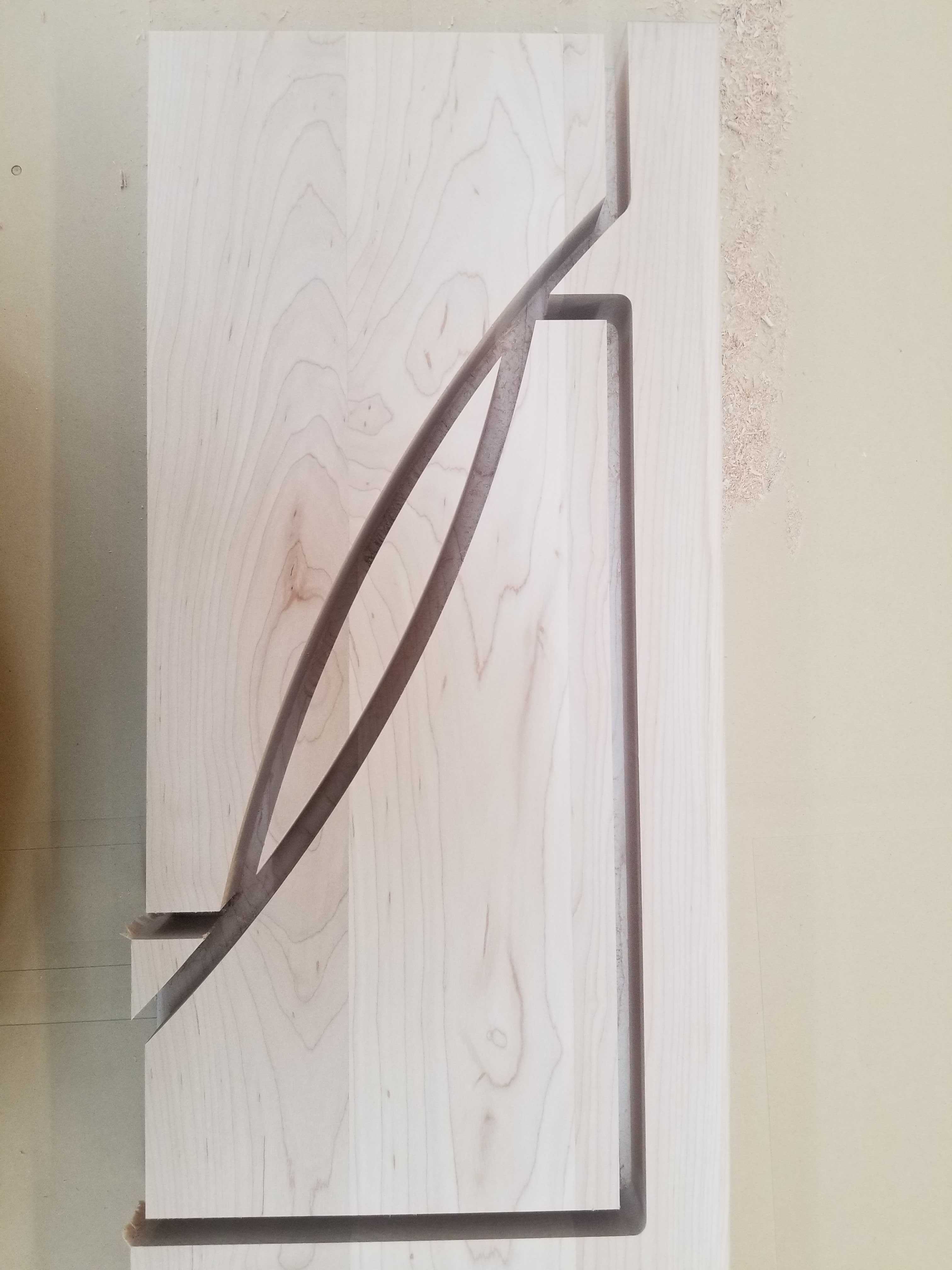

Just wondering if someone can point me in the right direction. I tried the roughing feature for the first time today, and it didn't work as expected. The roughing pass automatically created large radiuses on the corners of the part, and the final outline pass didn't touch the part at all. I set it to do a 2mm cleanup pass, but the tool didn't touch, leaving the part unusable. See attached pictures, the single part is the one I used the roughing feature on, the picture with 2 parts is without roughing. The picture with 2 parts shows the way the finished product is supposed to look like.
with roughing turned on, part unusable
without roughing, what it should look like
Upon closer inspection in control nesting, I noticed that the problem is apparent even in the diagram of the nest. notice the path with the radius is inside the final outline pass.

Thanks for the file and info. Looks to be something odd in metric. I'll pass it along to the software engineers and hopefully have it resolved for the next release.
Clint Buechlein
Posts: 785
Company Name: Thermwood Corp
Re: Roughing feature not working for me
Post by Clint Buechlein »
Tommy,
This one should be fixed in the 6.16 release as well.
