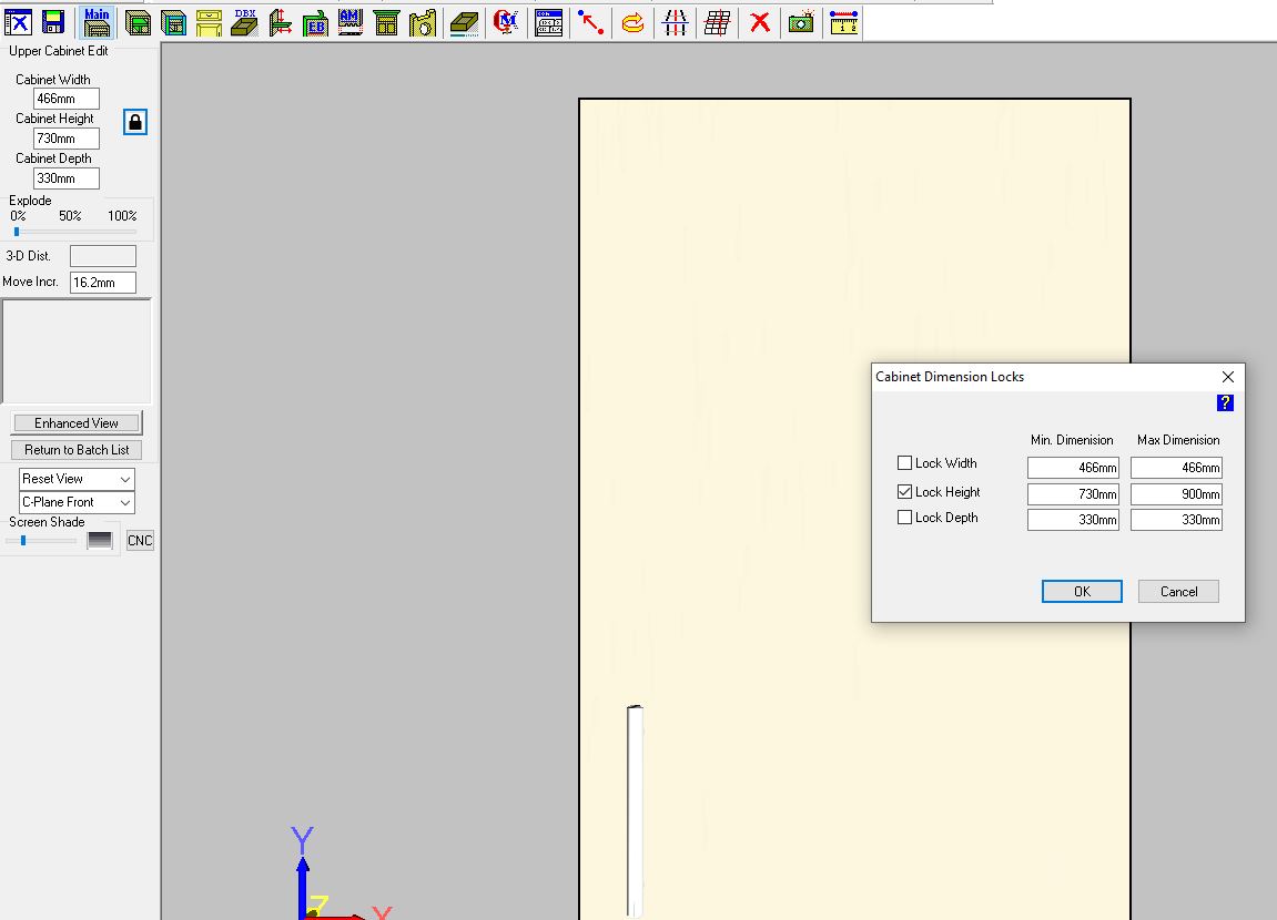

Looking for a way of getting rid of the adjustable shelves in an upper cabinet when it is entered into a batch list under a certain height. I don't see a simple way of doing this, anybody have a way of doing this?
- Posts: 563
- Location: Sydney Aust
Re: Adjustable Shelf Question
Theres no way that I know of.

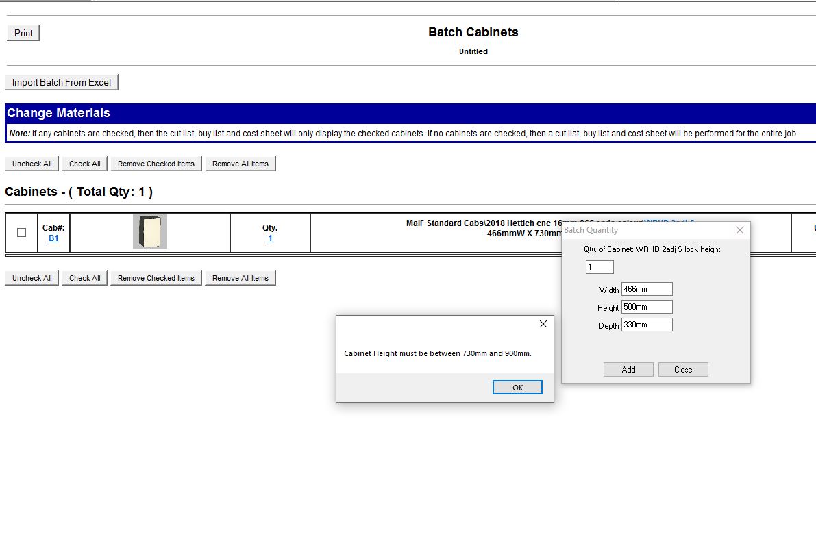

Perhaps you could set up the lock height so that if you go undersize or oversize you need to over ride it or load another unit.?

That would definitely do it. Its just a shame that there isn't an automatic way of getting there.
Ralph Balanik
- Posts: 198
- Joined: Fri, Jul 30 2010, 5:33PM
- Company Name: Ralph Balanik
Would it not be quite simple to create an upper cabinet with no shelves in it and save it in your library. You might call it range cabinet to designate it as a cabinet without shelves and make it an appropriate height before you save it. Then when you create your batch list just select it and adjust the size as necessary.
