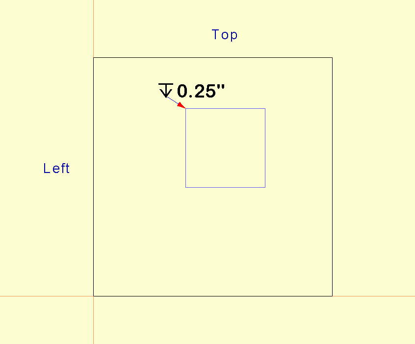

Not a big deal, Edit/Edit Depth button doesn't seem to be working. Can't select anything. But Edit/ Edit Constraint will let you select depth or constraints.

Seems to be working ok for me. To make sure everyone is using it correctly:
- If there is a depth constraint, you cannot use Edit Depth.
- If there is no depth constraint, you are not selecting a node, you just need to click on the geometry.

oooooh! Ive been clicking 0.25 and edit constraint. Been wondering why edit depth never worked :beer:
So if there is a constraint already just click on the constraint?
I seem to remember that it worked like Joe described before.?

Correct, if there is a constraint, you must choose Edit Constraint, and then click the constraint value.
