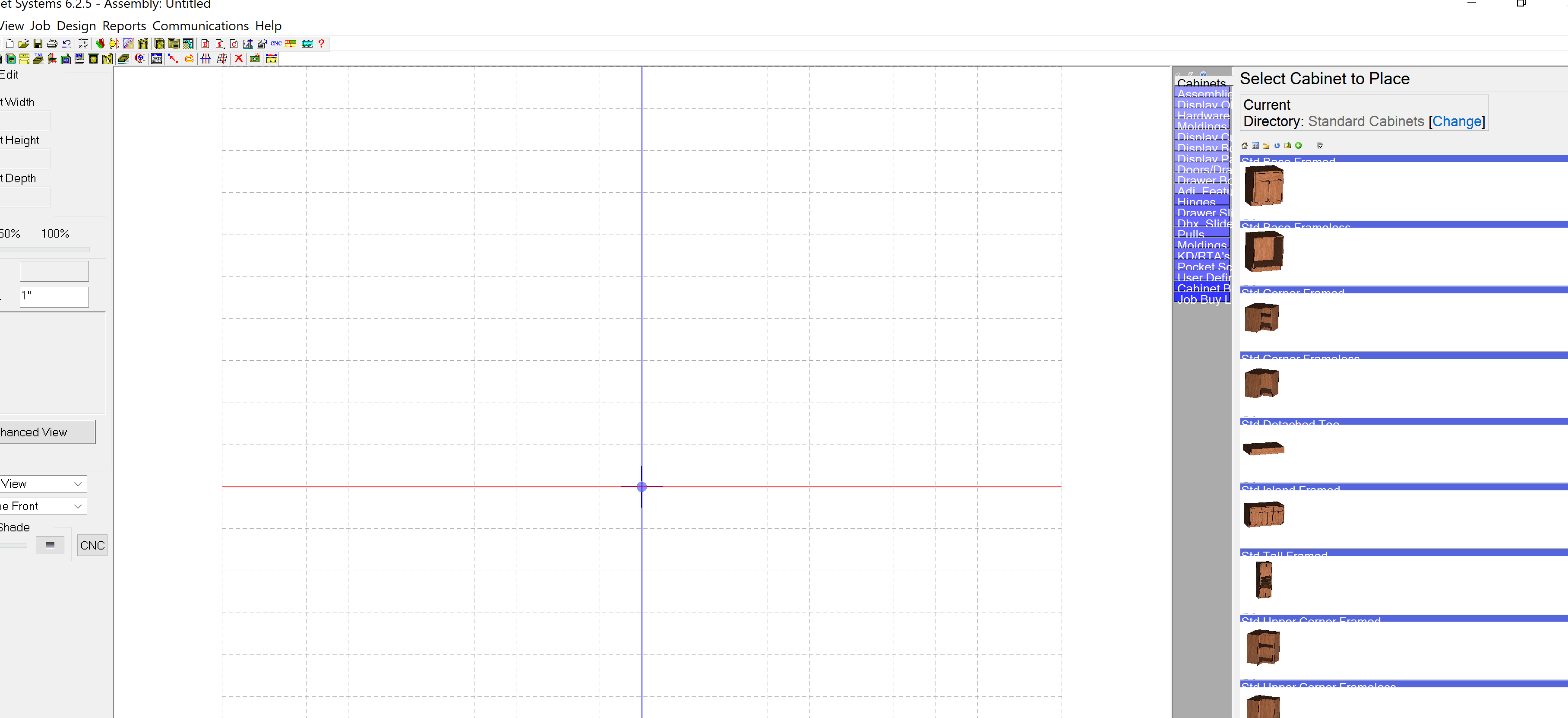

Hello,
I recently upgraded my laptop from an 10 year old dell (windows 7) to a new think pad (windows 10 pro). I download the updated version of ecabinets. When I open ecab the display is quite off with drop down windows overlaid over each other, as well as, the font and images viewing very undersized. I have sifted through the posts here and have tried all the recommendations but have not been able to rectify this issue. Please if any one has had this problem may you apprise me of the proper settings required for proper display of ecab interface.

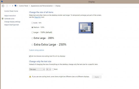

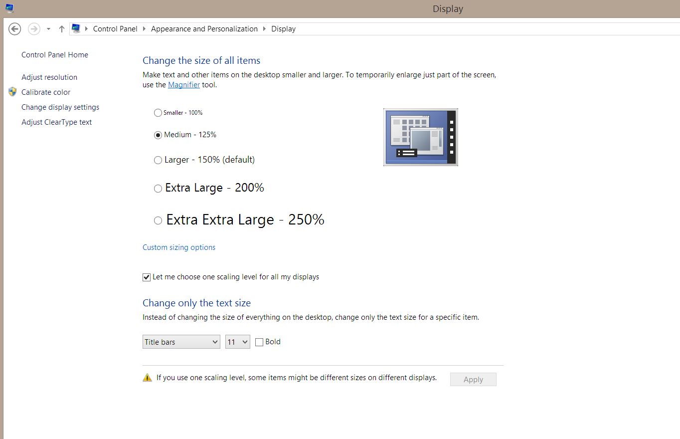

Welcome to the wonderful world of 4k resolution. I had the same issues when I switched to a 4k display. I'm betting that you have your or display scaling cranked up, just to make the tiny tiny letters legible. Doing that makes the fonts in eCabs large enough to read, but the rest of the interface doesn't scale along with them, so you end up with the text and labels splattered all over each other like that.
Although I'm using Win 8, I think Win 10 has a similar display scaling setting. I've attached a screenshot of it. 125% is as much as I could set it to before not only eCabs, but most programs, would exhibit issues with huge fonts on tiny controls.
So, turn that scaling level down and put on some glasses to read the screen. That's what I have to do. Getting old sucks.

Jeremy Schiffer wrote:Welcome to the wonderful world of 4k resolution. I had the same issues when I switched to a 4k display. I'm betting that you have your or display scaling cranked up, just to make the tiny tiny letters legible. Doing that makes the fonts in eCabs large enough to read, but the rest of the interface doesn't scale along with them, so you end up with the text and labels splattered all over each other like that.
So, turn that scaling level down and put on some glasses to read the screen. That's what I have to do. Getting old sucks.![]()
Thank You Jeremy, I will try this out on my new laptop! Yes getting old does suck. I feel a bit wiser..
