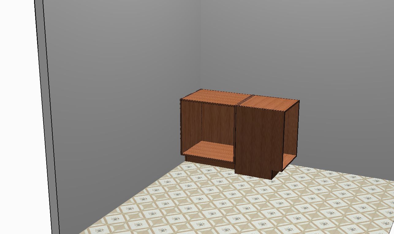

I would like to create an assembly consisting of two base cabinets.
A Right Cabinet and a Left Cabinet.
The Right Cabinet with = depth of the Left Cabinet.
and here's is the trick, the Right Cabinet's back attached to the  Left Cabinet right side end.
or in other words, the Right Cabinet front facing 90 degrees to the right.
I tried to do it on the Custom Layout but to no avail.
Any help would be greately appreciated.
						placing a cabinet back to the side of adjacent

Hi, Gheral Is this what you are wanting to do?

You can select the cabinet, change the placement to Free Style, then rotate the cabinet so it fits where you want it.
