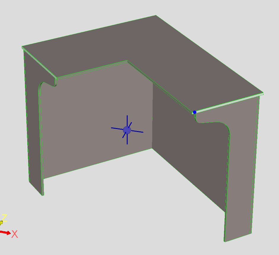

In the attached corner cupboard It is a square corner front with an applied Chamfer in the part editor.
CF Wip Top.jpg (6.85 KiB) Viewed 5247 times

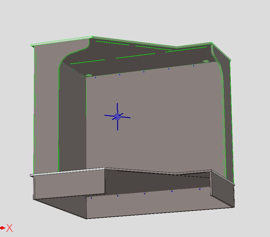

To rebuild the top shelf I am in the main screen.
Highlight cabinet, green hash top shelf.
right mouse click
Select remove part editor cuts
select , from selected part.
It rebuilds the shelf.
Highlight the cabinet, and for me the top shelf is unresponsive.
The other pieces in the cabinet can have the blue attachment dot but not the top shelf.
Green hash the top again.
Go to the part editor. do nothing.
exit to main.
The shelf has now regained its responsiveness
Unable to select points on top shelf

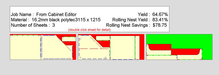

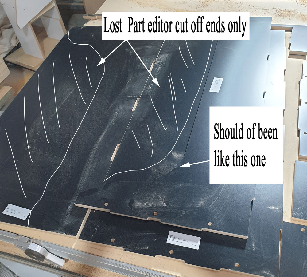

I persisted with this corner one, because it seemed to have come good, I had put a fair bit of time into it already, and didn't want to restart from scratch.
However I forgot to monitor it at the machine. And even if I had noticed the missing info we have to get the job out anyway.
And redoing it would have slowed us down anyway.
If I had to pick the part that would fail I would have predicted the top and not the ends because that was the bit that was playing up, and the top has a few extra PE pockets.
It was part of a batch.
It contained 8 assembly straight units, the corner above and some little units.
The edging dropped off all but 2 small units, we can get around that, but it shouldn't drop off.
I'll send it to the TW guys to put on the mantle piece, but I don't know what caused it.
