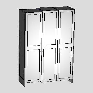

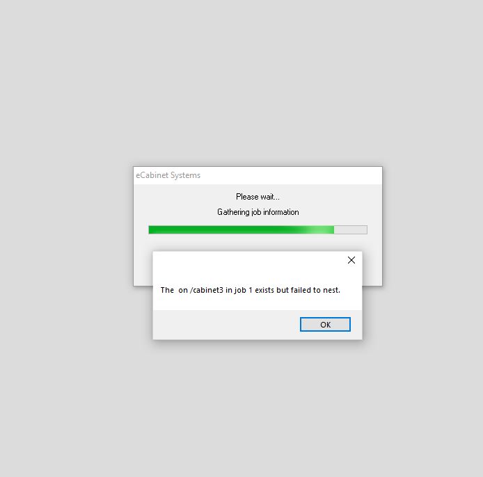

An assembly from before Christmas that the customer wants to height change.
Go to tweak it,..... Dead
By that I mean, try and optimise it or sheet layout and I get a error message.
What caused it? Dunno.
Should have been be a pretty simple job, except for the pigeon holes, partitions for drawers and sorting the hinges around the pigeon holes.
But maybe you guys can help find the cause.
This is a message Ive not seen before. Don't know what caused it of course, but posting because the hive mind is stronger

I've had these gremlins sneak into jobs on many occasions. I tweak a cabinet and all of a sudden materials are no linger displayed like they should be. I just get the yellow with text in it for a material I've been using for years. I also start getting constraint problems that just all of a sudden creep into a project.
Like you, I don't have a clue where these problems are coming from and what was done to cause them to happen. Also like you, I find i quicker to trash the job and start over. I get error dialogs that mean absolutely nothing to an end user. I've reported a most of these to Thermwood. I know the guys at Thermwood are working hard on eCabs. But maybe we are pushing it to hard? Don't know.

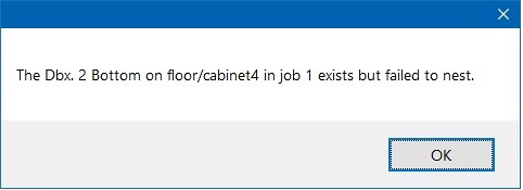

Here's a good example of those gremlins slipping in when you can't recall anything you did to make it happen. I was performing a nest for a job and this popped up out of nowhere. The message doesn't mean anything and doesn't provide any kind of a path to try and diagnose the problem. When I go into cabinet editor, it does not tell me which drawer is Dbx 2 so I have no idea which drawer box to even troubleshoot. Nesting arbitrarily assigns Dbx #'s but these don't carry back into cabinet editor anywhere, so it's really tough to try and figure out what is wrong and where the problem resides.
I just hope I don't have to delete the cabinet and start designing it over again, wasting a TON of time. It's a complicated cabinet to redo.
Sent this one to Thermwood to see if they can help me out.

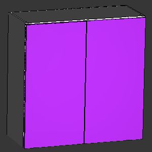

Here's the cabinet that started throwing the unknown error. It is a cabinet with drawers and pull out trays behind doors, just like you mentioned. It is a blind corner cabinet.
Base - right of dishwasher.hsf
(1.85 MiB) Downloaded 1484 times

I get the same error message when nesting your unit.
When I remove part editor cuts from the entire cabinet it nests.

Clint sent me an email saying the top drawer behind the doors is messed up. One of those gremlins. I haven't touched that drawer since I designed the cabinet 2 months ago. Don't know why it all of a sudden lost its brains.....
He said to delete it and put it back in. That's the kind of stuff this thread is all about. Issues like this popping up for no apparent reason. Delete and re-add the part, etc. Why is it having these problems in the first place? Sounds like cabinet data is getting corrupted either saving it or loading it. I know it's nearly impossible to find from a programming standpoint. I was a programmer for 18 years. Started with jumper cables, to mainframe punchcards, Unix, Windows from 1.0 to XP before I finally said I'd had enough in 2000.

Well here is another one...This one popped up while just nesting the job in eCabS on my workstation. It is a large job that I put together yesterday with seeds that are literally years old, but the cabinet in question is one I've used hundreds of times before. The curious thing about this error is that it references cabinet 17, which is an UPPER cabinet! No drawers! Soooo....what do I do with that?! I'll attach the cabinet but I'm not sure it will actually help.
I'll be honest, I've been very pleased with the functionality of this piece of "free" software. It works great about 98% of the time. That said I think we are going to be moving to CV. Just as soon as I can learn it. :wall:
double door.jpg (8.36 KiB) Viewed 32562 times
double door.hsf
(594.02 KiB) Downloaded 1423 times
2021-02-02 07_36_32-2021-02-02 07_11_16-eCabinet Systems 6.2.7 - Job_ BALANCE PL1 02012021.jpg
2021-02-02 07_36_32-2021-02-02 07_11_16-eCabinet Systems 6.2.7 - Job_ BALANCE PL1 02012021.jpg (780 Bytes) Viewed 32562 times

Stuart,
Your cabinet nests fine here by itself.
Many times the really weird stuff will go away once you save the job and shut down the computer.
Don't just re-start, shut down and re-open everything.
