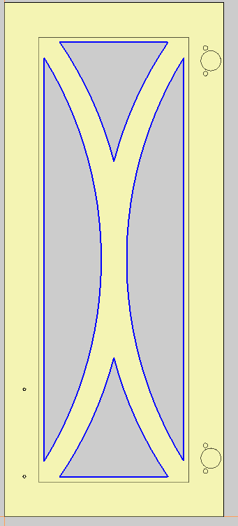

Hi, so i've been working with complex glass doors on ecabinets and there are many bugs that i get when its time to look at it in profile modeler my cnc qcore computer usually crashes when loading the doors to verify tooling, is there any way to get profile modeler on my normal windows 10 computer so i can troubleshoot quickly before finding out it wont work at the cnc computer.
i have the x_t for the doors that geometric cutout and then profile and it shows it would be good until i bring it to profile modeler ps. i couldnt provide the x_t file that can be imported into contour and the exterior works perfectly but the interior does not

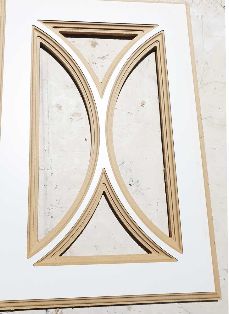

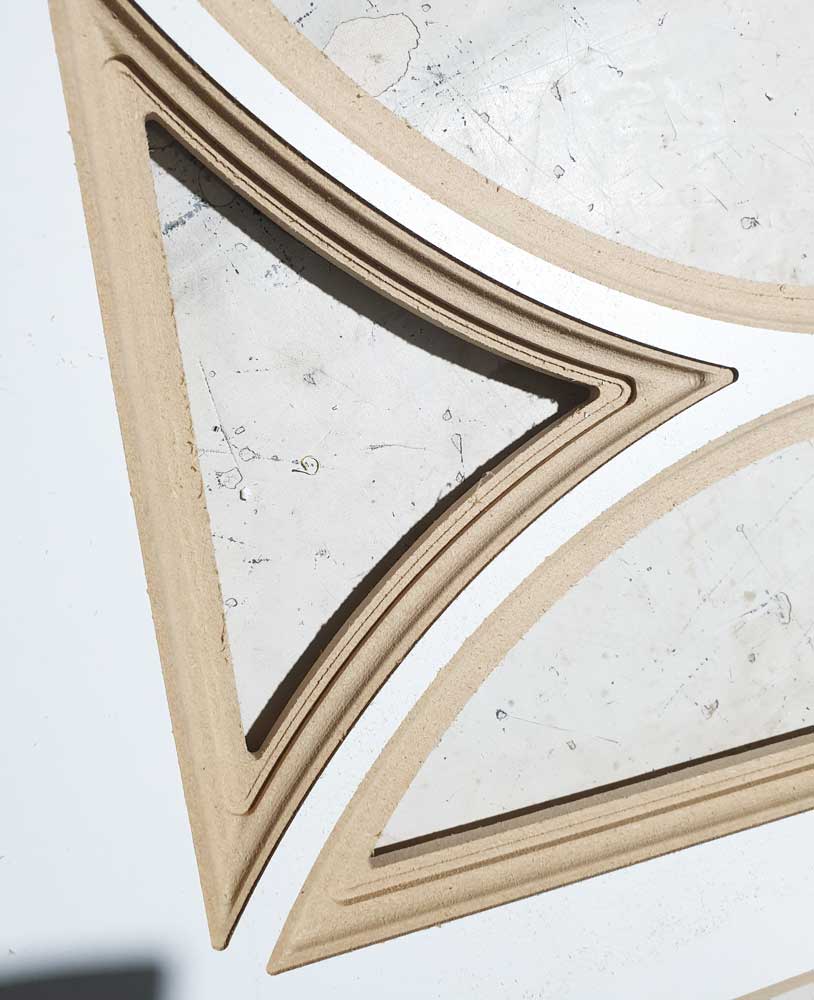

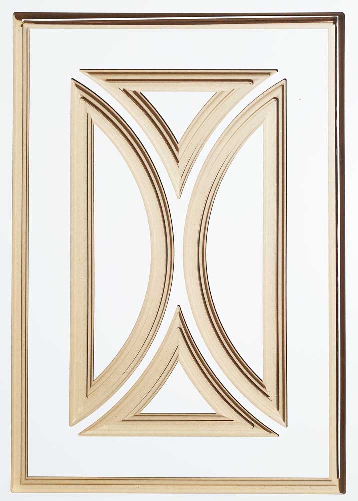

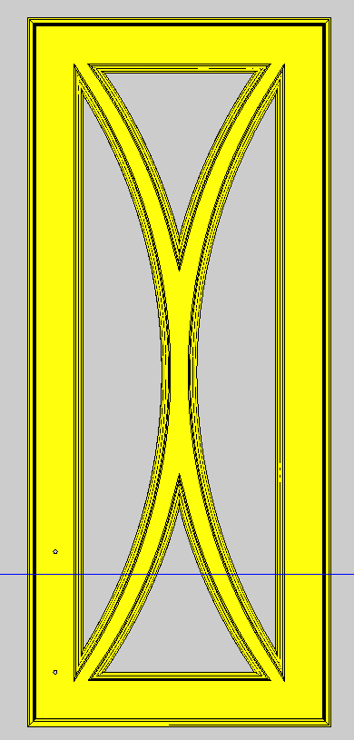

Hi Nicholas
Nice looking door.
I was curious to see how it would go with our tool set up because I had some troubles before on a similar profile.
Clint and the guys spent a lot of time to help us sort it out.
I ran one on an off cut as a test to see how it would go.
Because it was a off cut I didn't line the flip op up exactly, so the pockets are about a mil and a bit off.
That's your .tol file which seemed to work fine for me.
It nested and graphed without problems.
If time was of essence it might save a bit by halving the .tol shape for the interior as the machine shaped the whole double sided profile of the interior profile before pocketing the whole lot including half of the carefully profiled interior profile, (actually I cant recall if I pocketed the lites from the front or back in the part editor, which might affect the pocketing sequence) I set the pocket for the glass at the back to 6mm so it left that flat at the bottom of the front profile which could be eliminated by making the back pocket deeper.
The smallest tool I used was 1/8" but the corners are not as sharp as perhaps could be desired.
Nice looking door.
