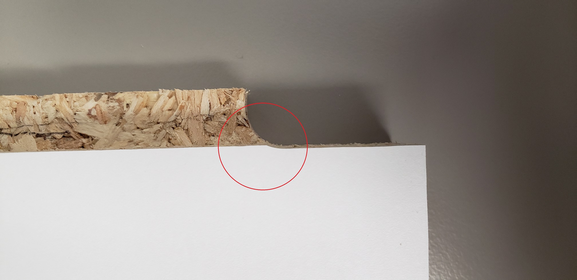

Can anyone shed some light on this issue. 3/8" cuts the tenon. 1/2" cuts the outline.
You can see in the picture that the 2 cuts are not lining up. I have checked the diameters of the 2 tools.
I have seen this before but cant remember what the fix was
Can anyone help

We definitely had an issue that caused the same result, and it turned out that the bolts holding the Z-axis guide rails to the mounting plate had come loose, and the head was wandering because of it. Check all of your fasteners, including the ones holding the motor to its mounting plate.
