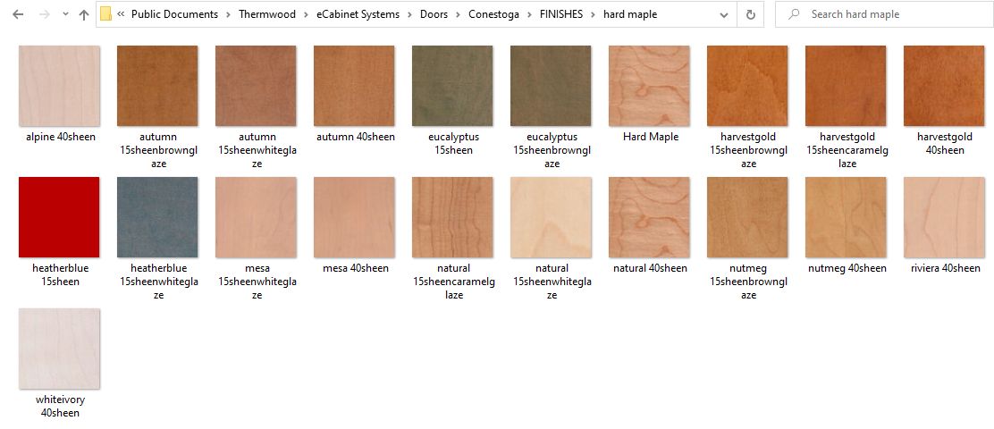

I took a screencap of a Walzcraft solid color, their "Classic White," and using an editor, changed the .jpg size to 100 x 100 pixels, same size as all the "finishes" in the out-of-box directory of finishes. I copied and pasted this color, this 100x100 .jpg, into the finishes folder in my Thermwood directory.
See the pic for how that folder looks. You can see the color image at bottom left.
But it will not work when I go to "apply" this "finish" to a Conestoga door TW-10 brought into a library I named "My Doors." Any of the other finishes will "apply" but not this one. Why?
I can use the color for edgebanding stock, but not for doors or drawerfronts. What is the secret.

My file structure is PUBLIC DOCUMENTS>THERMWOOD>ECABINET SYSTEMS>DOORS>CONESTOGA>FINISHES>HARD MAPLE
In that FINISHES file called HARD MAPLE, reside all the different stain colors that came with the program, all are 100x100 pixel .jpg images, and one I added that is the Walzcraft standard color I called Walzcraft Classic White. Before adding it, I made sure with an image editor it was 100x100.
I use your exact sequence in the door designer mode, that you described in text and then video, and the finish will not change.

To change color for a Consetoga door you have to change the color jpeg of one of the existing Conestoga colors. I went to
C:\Users\Public\Documents\Thermwood\eCabinet Systems\Doors\Conestoga\FINISHES\hard maple and chose the heatherblue 15sheen jpeg with a red jpeg image the name has to remain heatherblue 15sheen
You also have to change this image jpeg in your materials folder
C:\ProgramData\Thermwood\eCabinet Systems\materials\Hard Maple heatherblue 15sheen
You can now use this texture image from the hard maple selections in ecabinets. it will still be called heatherblue 15sheen but will have the texture image you replaced it with.
The catch is, when you replace any of these images make a copy of both folders you changed the image in and keep them as a backup because every time you get an ecab update it will overwrite your changes.

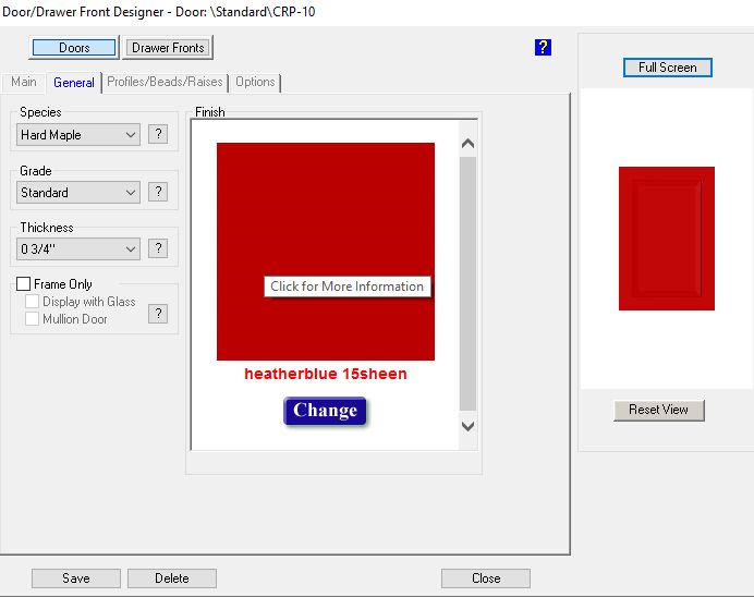

Here is a screen shot from the Door Designer with the CRP-10 door and the changed color
