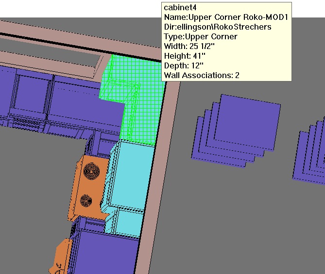

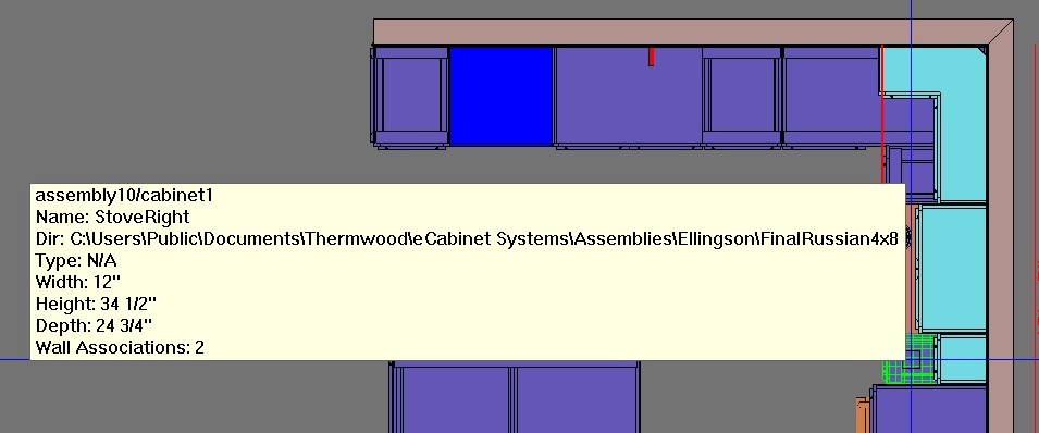

I created an assembly saved to a directory. No prob. I then wanted to save it to another directory. Saved both the cabinets and assembly to new directory. When I returned to room (applied changes), it still shows the cabinet (assembly) under the old name. If I choose the assembly and return to cabinet editor, the new name and location are in the box on the left, but the bar at the top still shows the old location and name. I have made new directories both as sub-directories and higher level directories. Where did I boo-boo?
Wrong directory
Wrong directory
Right directory
Right directory

Just because you saved it under a different directory doesn't change the cabinet that is in your layout. You will need to delete the original one and then load the second one you saved back into it's place in the room. This process makes the second saved cabinet the one in the room.
