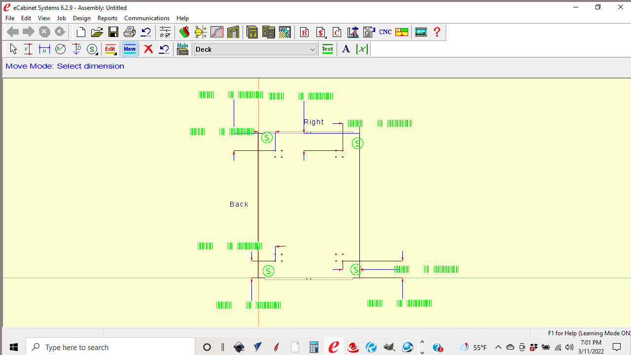

This Just started happening today while trying to constrain holes. When I set the constraint rather than showing the constraint I get this bar code-looking thing. see the attached image. Has anyone experienced anything like this? If so how do I go about fixing it?

Might try adjusting your text size.

Thanks, Donald I tried that but I still get the same results.

Ok. I was able to fix my problem. I made sure that all of my drivers were up to date. I also made sure that I had the latest windows 10 update. I still had the same issue. I then loaded the cabinet/cabinets that were giving me the problem. I deleted all of the constraints as well as the geometry sets and started from scratch all worked as expected. I am not sure which was the culprit here the drivers or the windows update or both but everything seems to be working now.

It may have been a incorrect font setting. Font settings can be changed by using the A icon in the toolbar.
