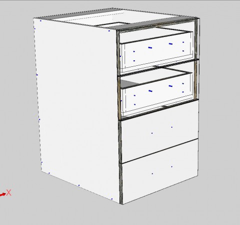

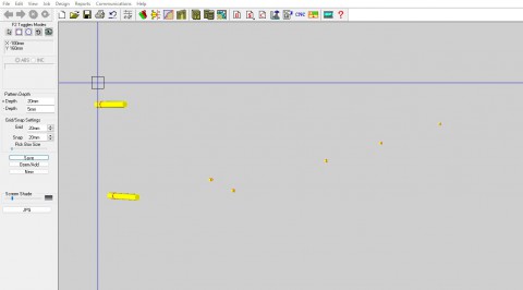

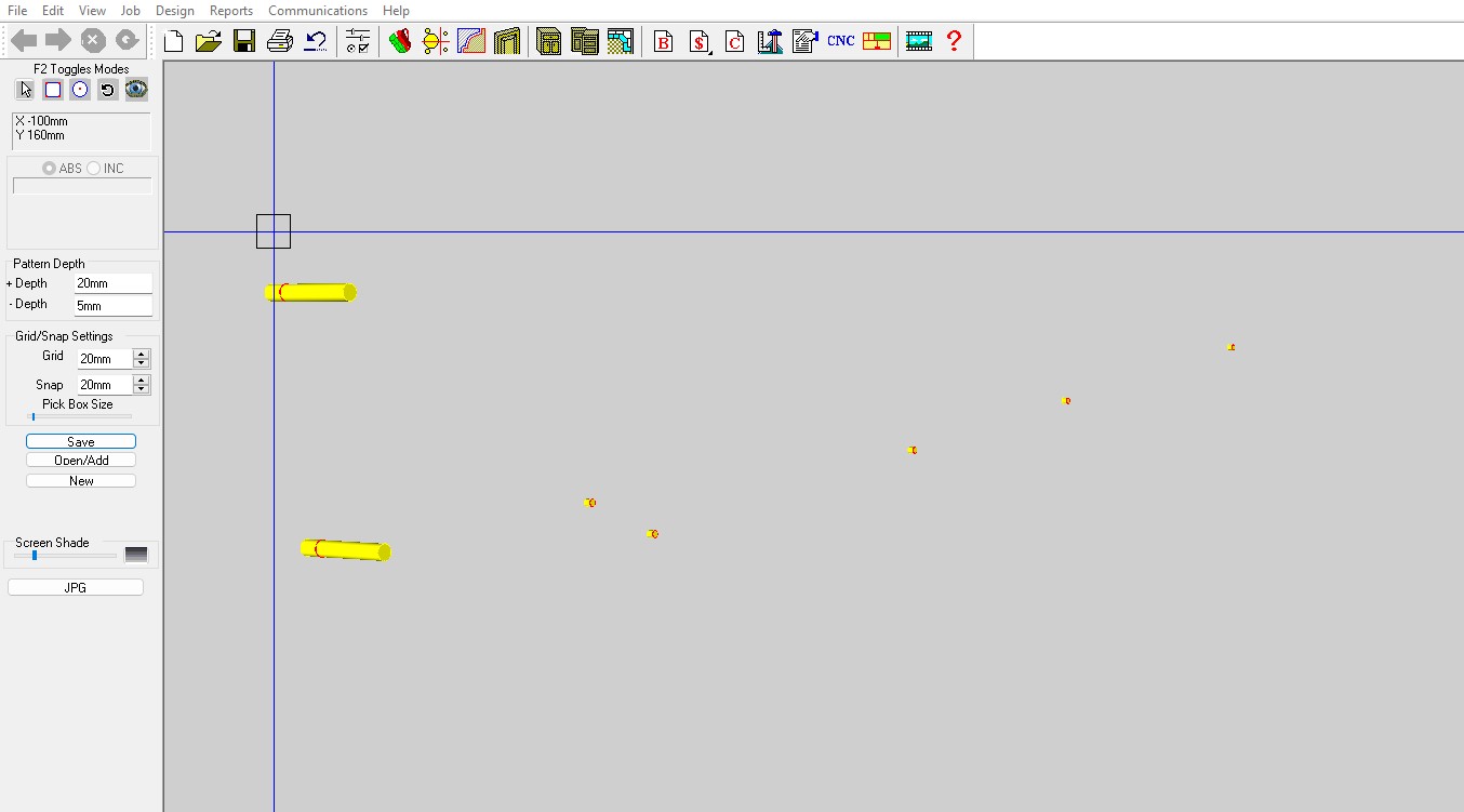

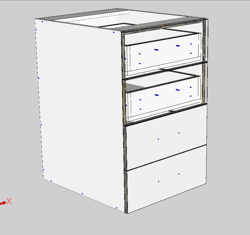

Hi Forest.
Is this what you want for locating drawer fronts? Through holes on the drawer box and pilot holes on the drawer front?
I tried to upload the ptn file from the hardware hole editor but it seems to be a forbidden file.

This whole time I thought the pattern moved from the side of the drawer towards the outside of the cabinet. I believe it used to work that way. Thanks for getting me to revisit that.
Forrest

Hi Forrest
I think they changed that when they introduced the drawer front connector dowel system,
It was in the back or my mind that it could be adapted to do this, but today when you asked the question it clicked into my head. :D
I had also been trying to do it with handle hole patterns, with no success.
See collaboration is a beautiful thing. :beer:
