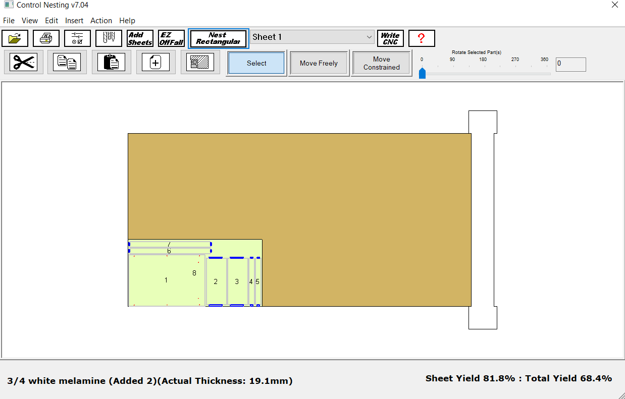

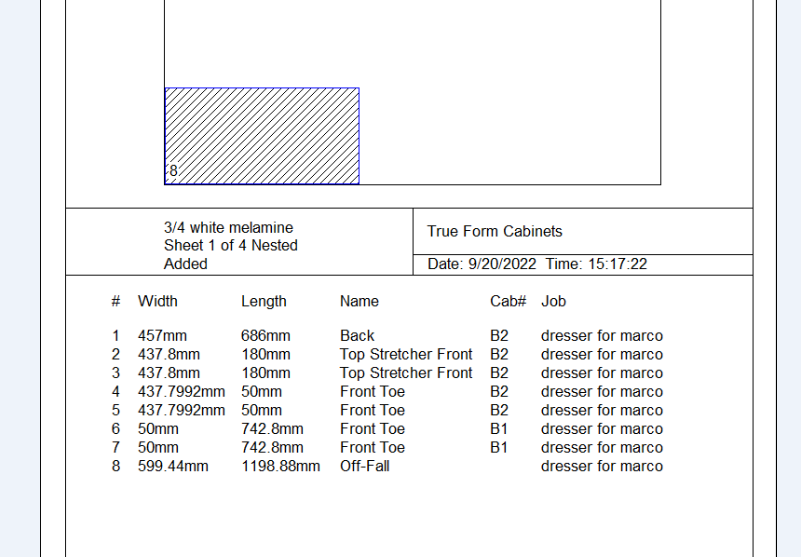

create a rectangular sheet and nest with rectangular optimization. the piece is green like an off fall and will not cut the pieces on it when written to cnc
