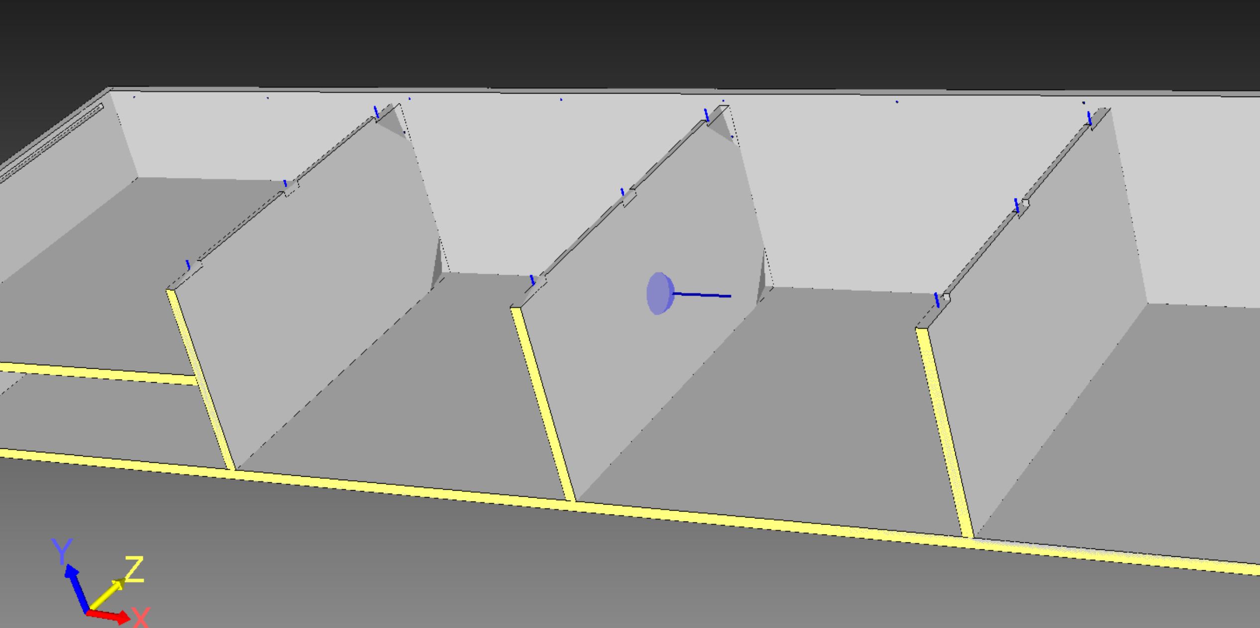

Hi Everybody
I changed my Monitor and since I have Problems with eCabinets. Please attached picture.
Please see the corners in the partition. It think it is Graphic issue and I tried already a lot and it is not changing anything.
Can anybody tell me what is going on and how I can fix that.

In your settings and preferences menu is a setting called tessellation. Try setting that smoother and it may solve your issue.

Hi Ralph
Thank you but it does not change anything.

Most likely need to update graphics driver from the manufacturer's site, not through Windows. You can do a quick check by checking the boxes for Force Software Rendering and Use Graphics Double buffering in Settings/Preferences. If it looks good after a restart, its most likely the graphics driver.
