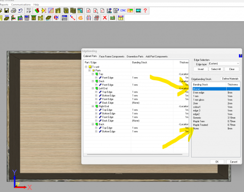

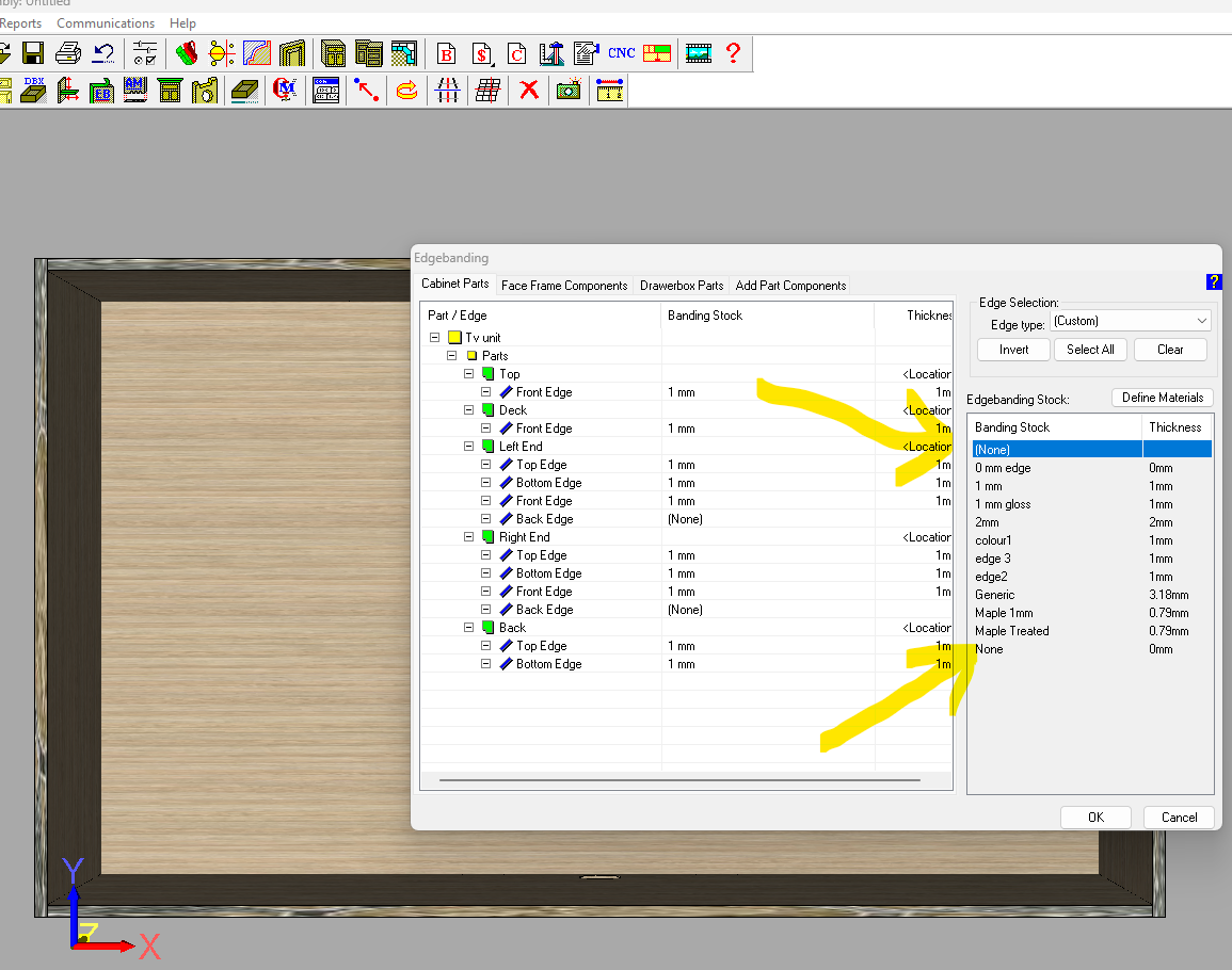

Do you have a edge band material labeled none or do you use the system [None]?
I had a material named none, and even now I can create a edge band material named None with zero thickness and add it to my materials.
As below for illustration.
I have deleted my material none, and replaced it with another name with a zero thickness, I cant say that I've noticed any less problems. But perhaps eventually all my units with none will get overwritten with the system none and get smoothed out.

I think the edge band thing is associated with a few gremlins
Maybe you have tracked it down.
