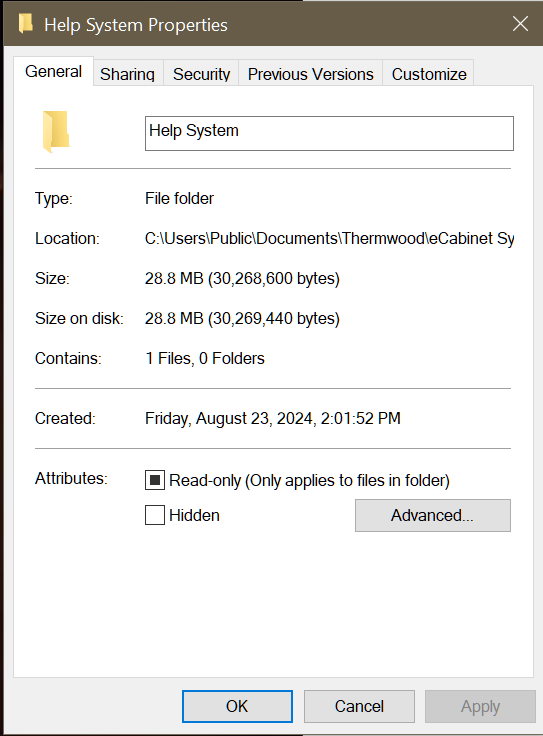

I may have figured it out - my User folder (and everything in it, including the Help System folder) is partially checked Read Only, and I can NOT get the **** thing to uncheck. Have I ever mentioned I detest Windows 10... I've had this issue before, and once I recall how to uncheck the Read Only box and have it STAY THAT WAY (are you listening Bill Gates?!) I believe the problem may be solved.
Scott, right-click on your Help System folder and see if the Read Only box shows checked, as mine does (see picture)

- Clint Buechlein
- Posts: 766
Re: help manual missing in latest version 6.2.12.1
Jeremy,
Good call on that one. The software engineer is going to see about putting in a check to see if the folder or existing help file are set to read only so the installer can do what it needs to do.
- Jeremy Schiffer
- Posts: 1151
- Location: Carnesville, GA
I have set every permission for everyone on this planet (and probably others) to be able to do whatever they want with these folders, yet they still show as (partial) read only. This is a Windows issue that I have encountered before, and it has to do with permissions getting screwed up and stuck when moving files from one hard drive to another, or other such manipulations. Not worth the time to try to trace it down at this point, so here is my solution:
1. Uninstall eCabinets.
2. Go to Users\Public\Public Documents\Thermwood, and delete the eCabinet Systems folder.
3. Reinstall eCabinets (did not require a new reg code, thankfully)
4. ????
5. Profit
Problem solved, I now have the proper help manual.

- Clint Buechlein
- Posts: 766
Be careful following those steps. If your eCabinets directory is set to default you will delete all of your cabinets, drawer boxes, patterns, etc. You likely could have gotten the same result from deleting the Help System folder, then running the installer choosing Repair.Jeremy Schiffer wrote: Thu, Dec 12 2024, 9:00AM I have set every permission for everyone on this planet (and probably others) to be able to do whatever they want with these folders, yet they still show as (partial) read only. This is a Windows issue that I have encountered before, and it has to do with permissions getting screwed up and stuck when moving files from one hard drive to another, or other such manipulations. Not worth the time to try to trace it down at this point, so here is my solution:

- Jeremy Schiffer
- Posts: 1151
Oh yeah, I forgot to warn anyone reading NOT to do what I did. We have all our stuff backed up, so I was willing to hose the entire install. So yeah, to anyone reading? Back your stuff up. lol
