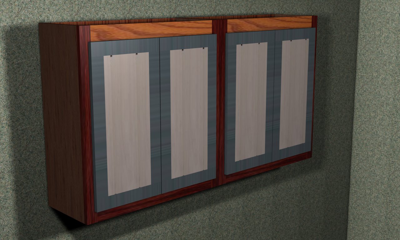

I had to try one
My setting
Over (-2\") Change to what ever your frame is on the cab. my was 2\"
Inseat (.7656)
I think I went the long way a round
The 2 nd Cab. I made the size of the door.
Cab. 24 x 34.5 x 24
2nd Cab. 21\" x 27.75 x 2 Deep
That is how I got the outer rail & Stile to change color.

This isn't great either but I did these using a slab door with a 2 1/4\" banding stock.
A Door Designer is supposed to be in the works at eCabinets which would probably let you do what you want with a five piece door but that is in a future release. For now maybe this would work.
