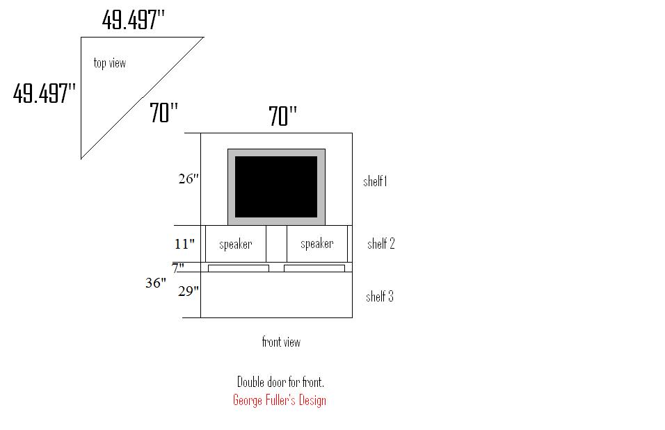

I like the designs that have been posted. I am currently designing a corner piece. For some reason the bottom shows the toe and I can't get rid of it. I would like for the corners to come together at a 45 degree angle with the left/right back. I drew it up before trying to design it in eCabinets. Excuse the simplicity. Does anyone have a similar design they would like to share? I would like to use 3/4 inch stock.

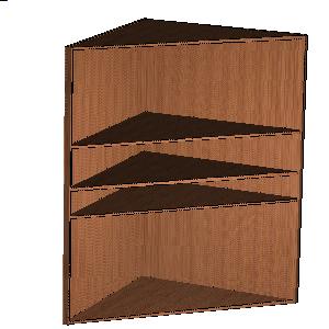

Here is a vers simple corner cabinet that you can look at to see the various settings I used to get what you want.
I has no doors, drawers or other embelishments but does have the size and shelves.
Hope this helps.
