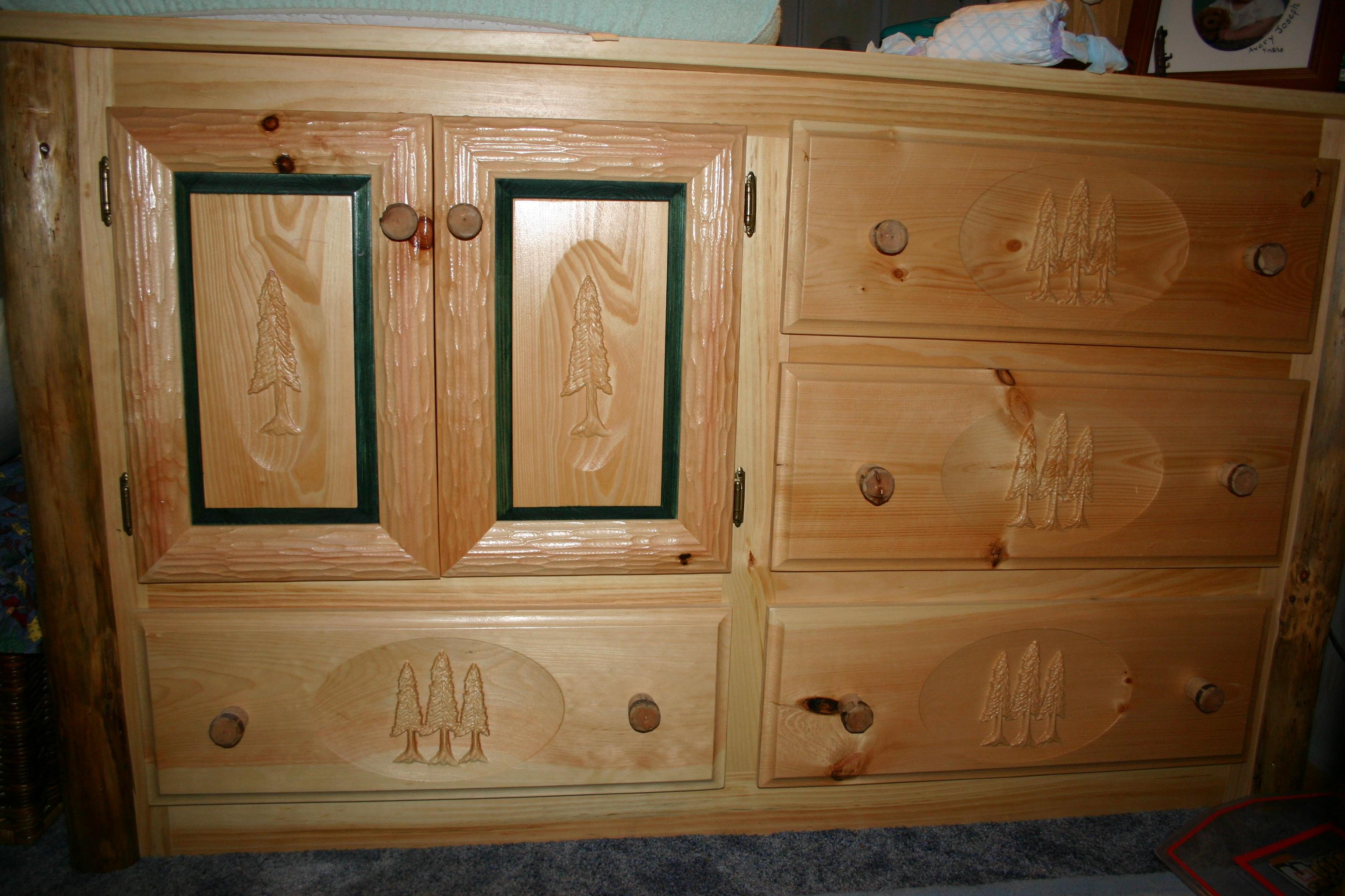

Ha! spot on Mike I am trying to get a \"chip carve\" effect. I have to make these MDF doors which are going to be lacquerd gloss black and the whole surface must look like its been carved with rows of short carved grooves running in parallel. I can get hold of BobCad and try it if you think it will do the job.

yes you can do it in BobCad21 but ArtcamPro would be much easier and much faster. I am trying to find the example of what you are looking for. I will try to send it later.
Found it. This is not mine but was designed and toolpathed in Artcampro
chip carved doors.JPG (623.96 KiB) Viewed 11057 times

That is not my personal taste but I sure can appreciate a well done piece in other styles.
