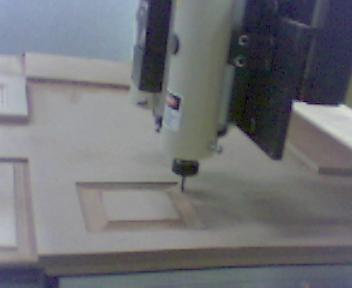

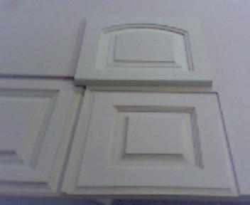

Brian, you should be good to go. I didnt have the 6020 so modeled it with the .25 compression I had loaded. The others some I did earlier. All using the same .25 bit on regular mdf so they were a little hairy but sanded eazy. The photos were took with the web cam on the controler so they are not very clear.
Joe
your door
your door
Picture 012.jpg (6.99 KiB) Viewed 38786 times
still carving
still carving
Picture 011.jpg (8.68 KiB) Viewed 38786 times
carving your door
carving your door
Picture 010.jpg (9.44 KiB) Viewed 38786 times

i am seeing a lot of doors with similar numbers, where the decimal is in the wrong place. glad to see you are having some sucess with the mdf doors

'Looks good Joe!
I would also have to model the 6020. This is the door that I had trouble with the cutting too deep. I wonder why it worked on yours but not on mine. I will have to look at it again on Monday. Thanks for running it.
