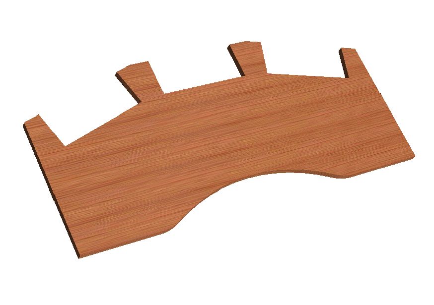

Hi,
We are having trouble cutting the attached Worksurface top. We are very new to using a CNC machine, We have the CS45-510. Is it possible to set up cut pass thru stages. The machine tried to cut this top in one pass and broke the bit, is there away for the CNC machine to make 3 passes to complete a cut. Our operater did not think this was possible. The top is 66\"L x 30\"Wx 1 3/16\" Thick. Any help or suggestions would greatly be appreciated!
Dave

We adjusted the spoilboard and that worked
The top was drawn in autocad, dxf file and imported to E-cabinets.
The material was 1 1/8 Flakeboard with standard grade laminate on the face side. The bit that broke was a 1/2\"
