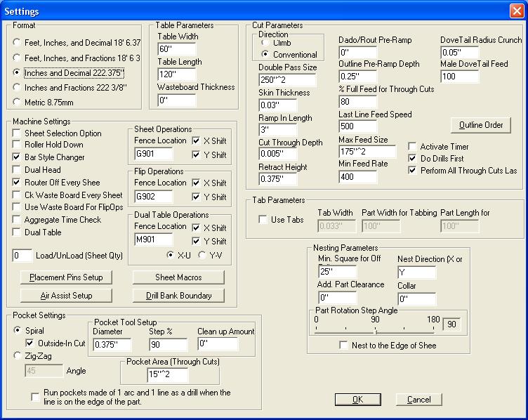

Hi Rob,
What is your diameter for your pocket tool setup set at? Is it the same size as the .5 tool that you have in your tool manager?

Jason Susnjara
Posts: 1653
Post by Jason Susnjara »
Go into Control Nesting. Then go into Settings. Pocket Settings is at the bottom left of the screen.
Rob Davis
Posts: 351
Location: Indiana
Post by Rob Davis »
0.5\"
Jason Susnjara
Posts: 1653
Is that .5 tool the same diameter as the tool that you are using in the tool manager? (F9, F2)

Jason Susnjara
Posts: 1653
Rob,
Change the pocket tool diameter to .25 and see if that works.

David Hall
Posts: 593
Location: Stamford, CT USA
Post by David Hall »
If you put a fillet on the inside corner of a pocket less than, equal too, or close to the radius of your pocket tool, you will get this error.
Same error will occur if the part editor cut is for the outline, and you have an in inside corner with a radius less than or close to the radius of your outline tool. (but this one sounds like it's coming from a pocket)
Remove the filets or radius from the cut/pocket, and let the tool leave whatever radius it can.
