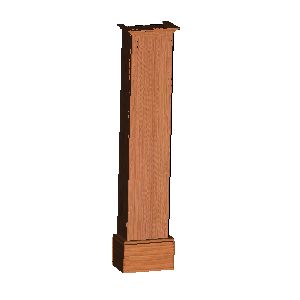

It worked great until I tried to run molding around it.
When I attempt to place molding on the front (back) of the pilaster, which is actually a cabinet turned backwards, the molding is facing the wrong way.
What do i do to get the molding around the pilaster???
Floyd Meredith
Inset the back to the front of the cabinet. :idea:
back to front.jpg (6.33 KiB) Viewed 8060 times
back to front.hsf
(87.4 KiB) Downloaded 762 times
With moulding.
back to front with moulding.jpg (6.1 KiB) Viewed 8056 times
back to front with moulding.hsf
(110.89 KiB) Downloaded 796 times

Rick,
Thanks for the tip. That was just what I needed.
