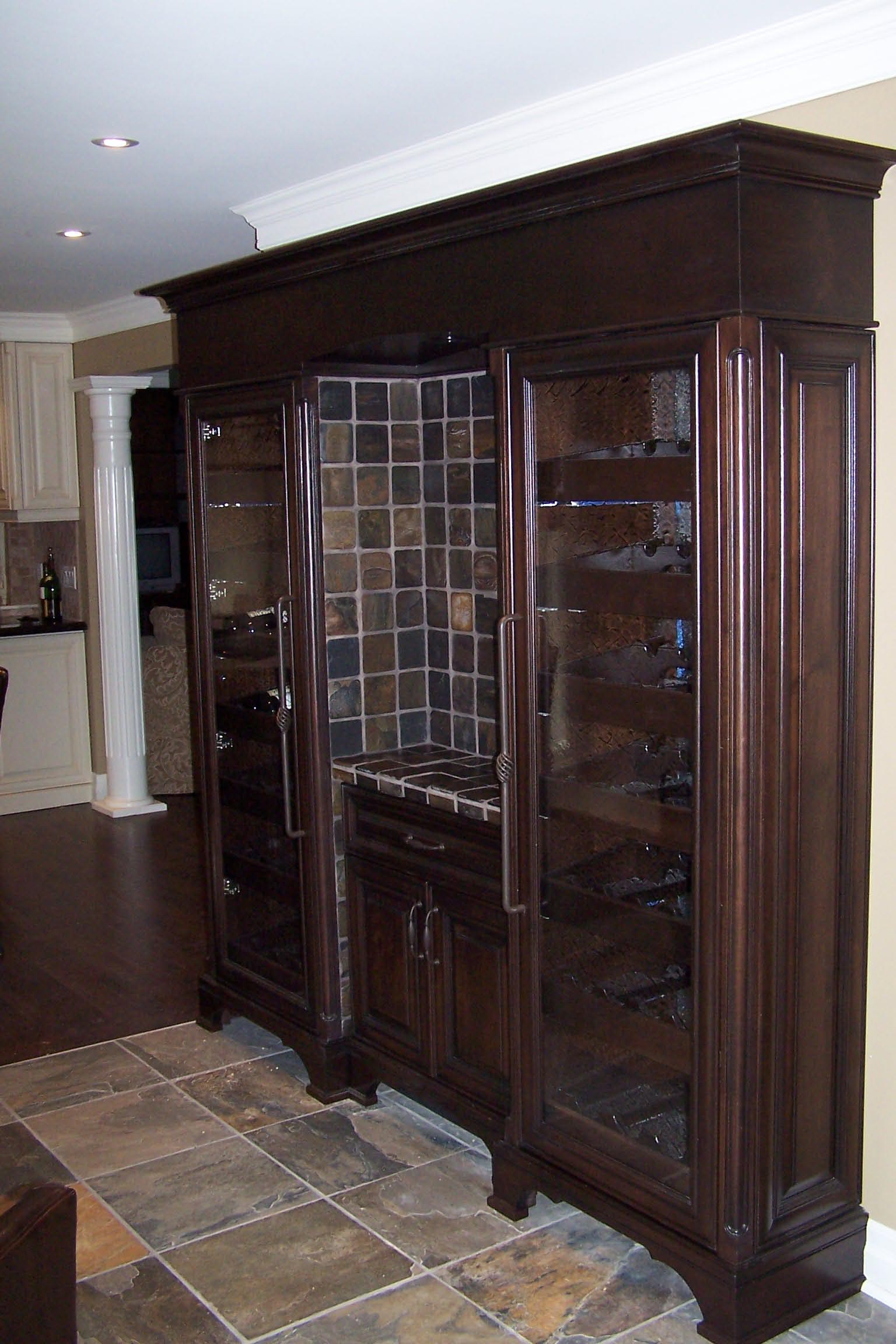

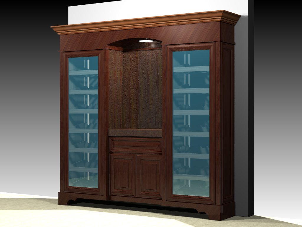

I sure had a lot of fun with this one
walnut inside and out with pull out shelves, back lighting, and a tumbled slate servery in the cente

Hey Mark Thanks for the compliment. I'll try to post a photo of the finished unit.
We did the Kitchen , an entertainment center and two vanities as well.

Peter you called the piece a wine \"cooler\" is there a refrigeration/cooling unit for the two side cabinets? I would be very interested in knowing more about that if so.

Peter Firth wrote:Hey Mark Thanks for the compliment. I'll try to post a photo of the finished unit.
Peter -- Very nice unit. I noticed that you added the 2 central legs, which I was wondering about when I saw the first design just now. It looks great.

Mark, regarding the cooling. I put an evaporater unit in the top of each tower with a walnut grid to hide it but not obstruct the flow of cooled air and the main compresser sits in a crawl space directly bellow the cooler. It has been up and running for about ten months and is working perfectly. Both sides are maintaining an even 57 deg. perfect for red wine and the customer can adjust up or down by ten deg. If a person wanted to cool for white wine a pair of dehumidifiers sould be added, stronger evaporaters and a double glassed front door. In this case the cusomer requested a set up for red wine only. Each shelf holds 5 regular wine bottles and the bottom shelf in each tower is set to hold 4 mags.

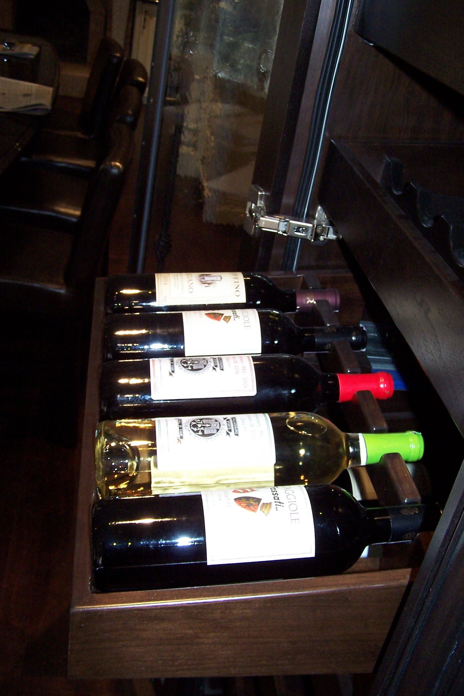

Hey Mark, the doors on the cooling towers have magnetic seals (seal built into the case work and a metal strip rebated into the back of the door and painted black). The sides, bottom, top and backs are insulated with one inch sm biult into the millwork. The finish is a jacobian (sp?) stain and catalysed lacquer on walnut veneer. According to the manufacturers specs on the lacquer it is fine for this porpose as long as you leave it to gas off and cure for forty days. We left it for sixty just to be sure. One other detail that doesn't show well in the pics is the way we built the drawers. Traditionaly you set the bottles slopping down to maintain a wet cork. In this case the customer wanted to show off their wine and display the labels. As a result I designed the shelves so they hold the bottles on about a 2.5 deg. incline and the but of the bottle facing the door. This worked perfectly in making the labels easy to see and the air bubble in each bottle is sitting neatly in the sholder of the bottle maintaining a wet cork. On top of that we used an accuride eclipse slide on each pullout shelf for a little added bling. This design does work well and I would be Honored if this has inspired you to pursue a market in you area. I just last week sealed a deal for a $150,000 - $250,000 (customer wants what he wants) job for the new year based on what this new customer saw of this job with the cooler.

Here is a pic of the pullout and bottle placement. I designed this on e-cab an wish dearly that I had access to a nesting machine at the time. It took a hundred hours to produce these shelves
Bottle and pullout detail
Work Pics December 2006 144.jpg (268.38 KiB) Viewed 31536 times
