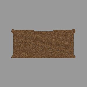

Here is what I came up with George. This is just a sample of course but you can get an idea of what I meant on the corners.
I started with a 24x36 display panel.
First I put a 4\" fillet on the two front corners.
Then I cut 2.5\"x12\" rectangles on each end and a 2.5\"x16\" rectangle on the front but DID NOT CUT THE RECTANGLES OUT.
Next I went to contour mode and created edges.
On these edges I places 2.5\" raduis fillets on all square corners except the back.
Then I left contour mode and deleted the three rectangles I had placed earlier--DELETE, DO NOT CUT.
Finally I created a part using closed contour then profiled the edge using a partial chain.
Fiddleback Top.zip
(1.28 MiB) Downloaded 1332 times

That is nice Dan

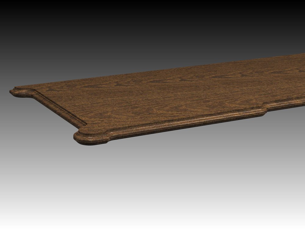

Here is a better view of the overall shape of the sample top.
