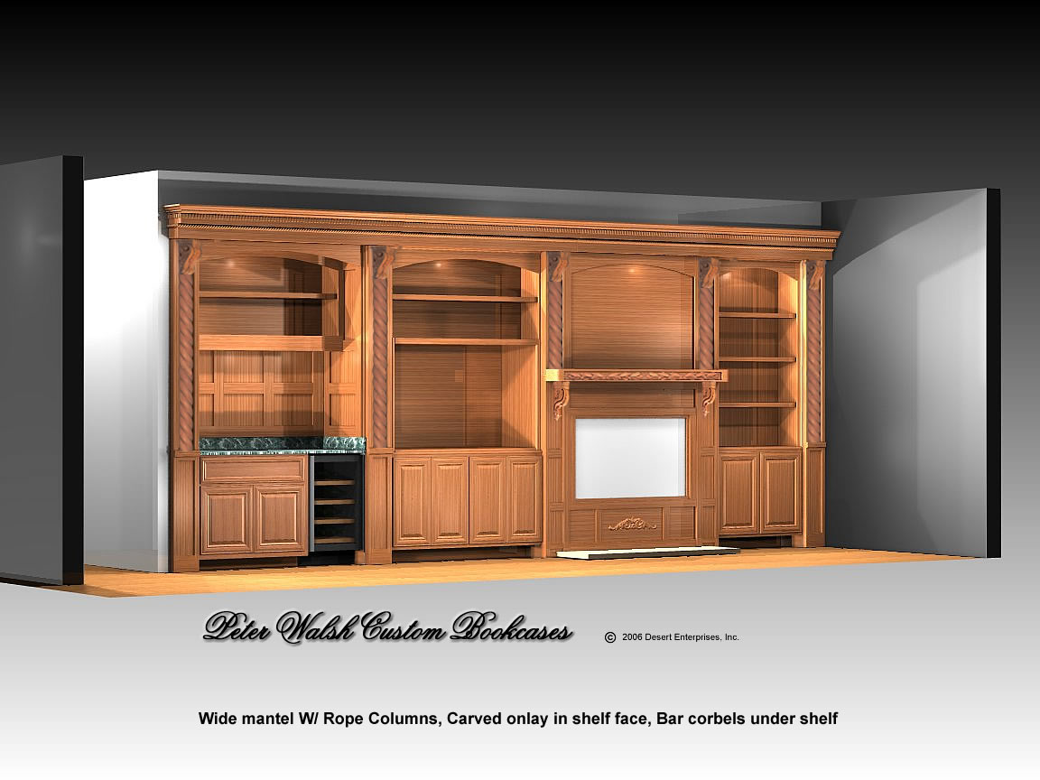

Here is the final upgraded Media/bar wall from an earlier post.
The customer added quite a few items including a mantel, fireplace surround (gas unit), rope twist columns, and mantel corbels. Increased the overall job price substantially.
Reminder.......the customer can't see what to add unless you show him. Every single improvement rendering I did in eCab resulted in an upgrade order.
Lumber arrives next week and we start cutting.
Merry Christmas to all!
Final Wide Mantel V2 eCab.jpg (115.81 KiB) Viewed 13248 times

Looks great Peter...can wait to see photo's of the finished product!

Nice work Peter! eCab really shows all of the details!

There is a little cheating going on. The twist columns and carved corbels were placed in the rendering with a graphics program (Fireworks).
Landed up with an order anyway.

now that you say that...they do look a little different in texture and sharpness - carving on the mantel as well?

Nice design Peter, I'm wondering about the back on the right unit, Why did the client wanted the grain running different from left unit top?

I didn't get notice of your posting on the cherry media wall project, so this is a late reply.
Good catch on the grain. That was the result of being forced to orient the grain in the first two cabinets sections because the width was way too wide for regular 8 X 4 sheet goods. In the right cabinet the problem is reversed and all the shelves are adjustable so it is either have a grain reversal or a horizontal seam. I opted for the grain reversal but may change my mind by the time I build that cab.
Since the reversed grain orientation was the way the project was presented to the buyer who has a copy of the image, I am not facing any surprises on installation.
