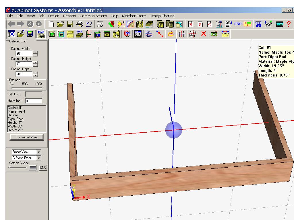

Joe -- All you have to do is create a toe kick from a cabinet and then save it as a cabinet. Then when you want to use it resizing is very easy. Here is one of mine.
This is what I use Joe.
Base.hsf
(94.32 KiB) Downloaded 2619 times

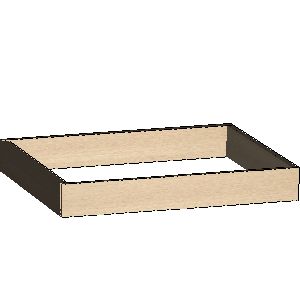

I cannot for the life of me figure out how to make the front toe be in front of the sleepers. I've fiddled around with insets and flushes and I'm stumped.
I basically want what the jpeg in Wally's post shows. Should be simple, but...der...i guess i'm simpler.

Is this what you need Brian?
Kitchen 21 Deep.hsf
(92.06 KiB) Downloaded 2537 times
Hey Brian, the one I use works around that issue quite well, and resizes no problem.

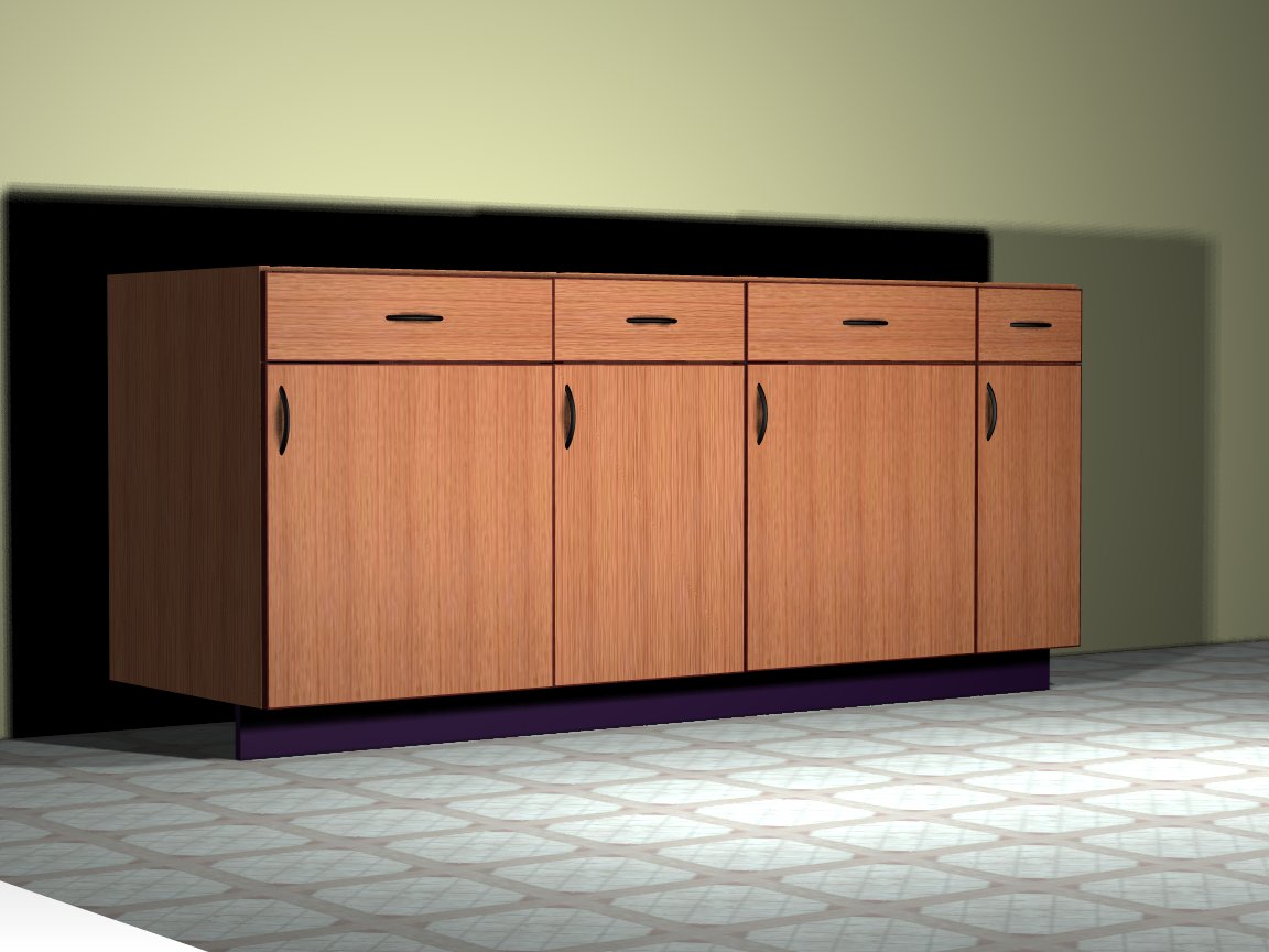

Okay guys, here's a work-around for people who just use toe-kicks with levelers. This is for display purposes only. By this I mean, you aren't going to use this method to give you toe-kicks for cutlists. It's just that I think it will make it easier to plop a cabinet in a room and have it look right.
Here's how I did these...
Take your basic cabinet box design and Add a stretcher of some bogus material (like generic black) of the height that your toe kick material normally is (like 4\" or 100mm) with an Up-down orientation.
Adjust the stretcher insets to put the stretcher below the cabinet where you want it. In my case this was Inset 2 = -4\" and Inset 3 = 3\".
Lock insets 5 and 6, then set these to a negative value equal to your cabinet material thickness. (Like -3/4\")
Now you have a toe-kick that will be placed with your cabinet box, but you can just ignore the material in your nesting.
In the rendering I placed the same cabinet in 4 places and just resized it.
Joe
