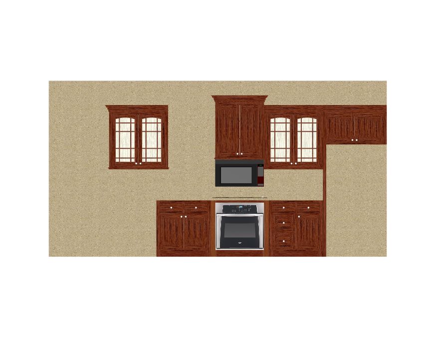

So you are saying that I can't do this (see image)?
First of all use the uppers that are on the angled wall not the uppers that have two 90 degree corners.
Make sure you are using inches and fractions.
Highlight the left upper cabinet
enter a value of 12\" in the left numerical position box.
hit enter
mine just moves to 13 9/32\" not 12\" as I had entered
It does the same thing on the wall you were on
highlight that left upper
enter a value of 12\" in the left position box
mine moves to 12 29/32 not 12\"
Gotcha...I was looking at the move itself and not the actual dimension after the move.
It doesn't have to be the angled wall either. The same thing happens with the straight wall uppers.
On the angled wall I moved the left cabinet to zero and it ended up at 1 9/32\". The left cabinet on the straight wall ended up at 23/32\" when I set it to zero.
Notice the 9/32 and 23/32 adds up to one inch.
You can get around this by subtracting 1 9/32\" (1.28125) from where you want the cabinet to end up at.
