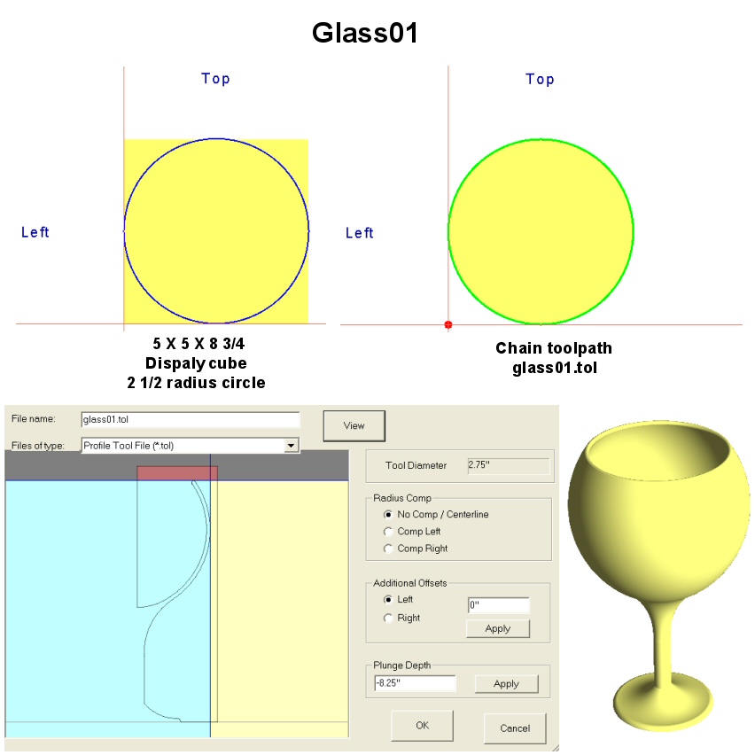

The zip includes the x_t file and tol file for \"glass01\"
I have updated this tool because the first one I had here was silly.
This one makes it easy to make and gets rid of the edges that would cut lips and fixes the top so that you could actually take a drink without pouring something in your face. But it is still a really big glass.
