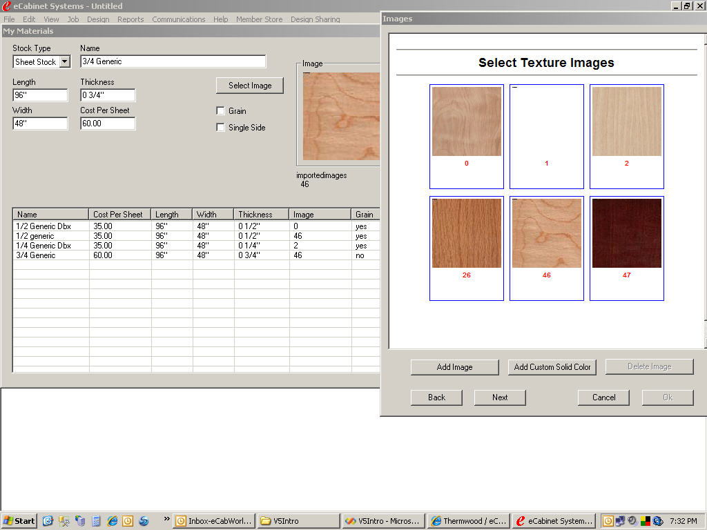

I don't even have a 17 in imported images. The attached image shows my imported images list.
I did some comparisons and 26 is actually Red Oak Nutmeg 40 Sheen. The \"normal\" generic color is Hard Maple from the hard maple folder or 46 in my imported images folder but it doesn't look like walnut though.

Go to Preferences/Define Stock Materials/ Sheet Stock/
Then select 3/4 Generic.
The image listed will be what your sheet goods will have when you select a standard cabinet.
Go to Preferences/Define Stock Materials/ Board stock and select Generic 2 X 3/4 and the image shown will be what your face frame stock will be for a standard cabinet unless you change the door.
If you have changed the Generic Materials textures then when you open a standard cabinet it will flash the original texture that eCabinets used then go to the texture that you have changed to.
I use one material called Stain and one material called Paint. I then just change the texture and pricing for these two materials to get my presentations. The only problem is changing all of the face frame parts but hopefully this will get easier in future releases of the software.
I have the original colors for generic materials and when I load a standard cabinet, it first loads with a Red Oak Nutmeg 40 Sheen then changes to Hard Maple. I haven't changed the generic colors.
